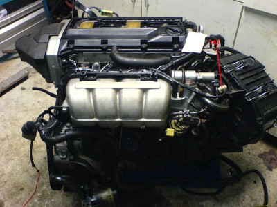

This sounds like an MAT sensor, NOT an IAT sensor. If you read anything more than 0.5 *C away from ambient while at WOT above 2k RPM, something is very very wrong with your car. IE, it's magical. For the time being, you must connect an IAT (not an MAT) to your IAT input. If you do not have an IAT, that sucks, but fix the car. Where is your "IAT" mounted, exactly? Post a photo?
i have marked the Sensor ! for me it is a IAT because it sits between the air filter an throttle body !
Yes right at WOT the temperature drops to ambient temperature but i am not driving all the time at WOT :? LOL
If i´m driving in the city temperature easily rises to to 60°C !
