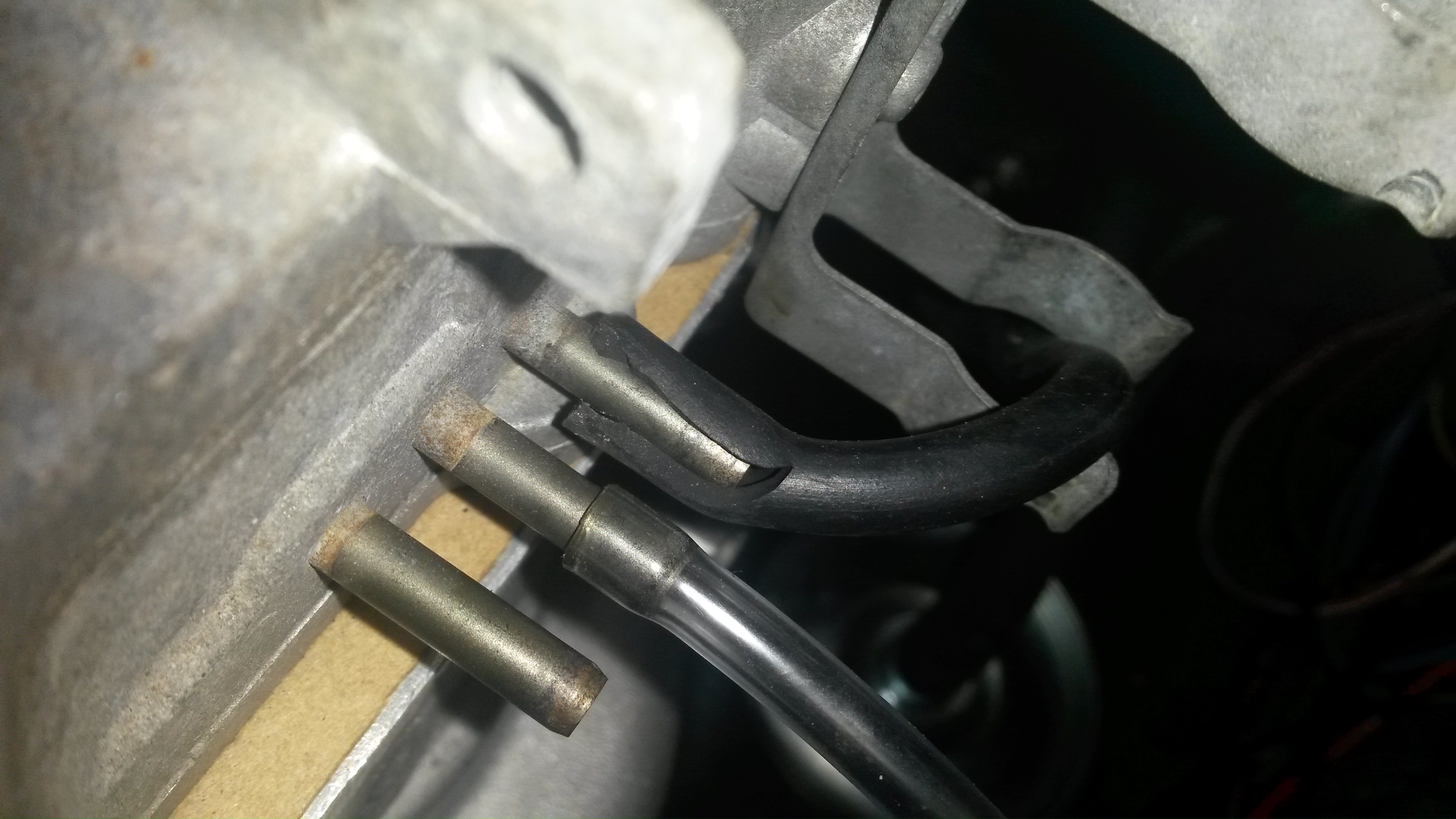

Wouldn't idle tonight... opened up a datalog... lowest MAP was about 60 kpa... opened the bonnet... and found this:

MAP vacuum line replaced and rerouted. Was full of fuel :-o Joys of TBI, I guess. Should be better now with the new routing.
