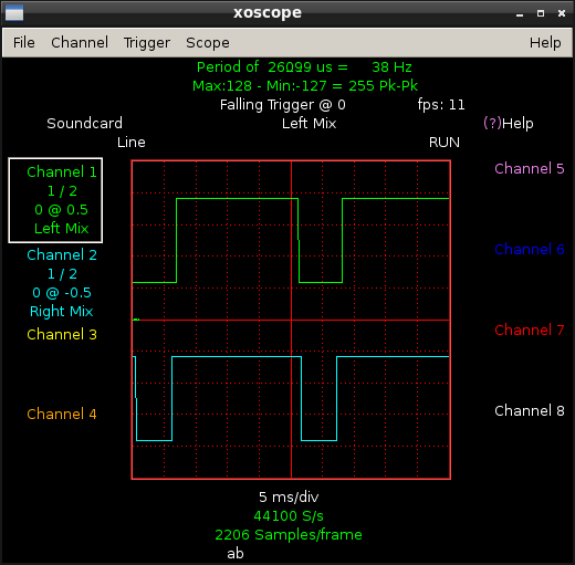

Here is the latest screenshot of xoscope after adjusting the Dwell to 18 @ 500 RPM, 16 @ 1000 RPM and
Timing table to have 0* at 44kpa/500 and 700 RPM
0* at 38kpa/500 and 700 RPM
0* at 32kpa/500 and 700 RPM

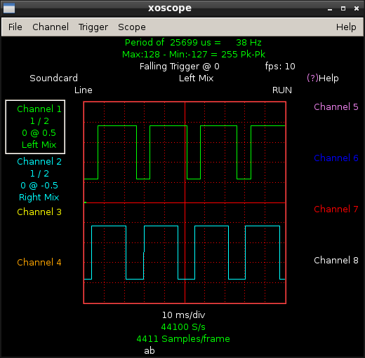

From IRC, FYI:
(22:51:44) Fred: "The PCM monitors the EST circuit by watching the pulses on the circuit. When the engine is cranking (below 400-600 rpm) the ICM grounds the EST circuit (bypass mode) and controls the ignition timing. The PCM expects to see no pulses (defined as pulses less than 1V) on the EST circuit at this time or else a DTC will set."
(22:51:56) Fred: EST is a low signal
(22:52:07) Fred: so the XOR should be inverted, and the dwell reset to where i had them
(22:52:44) Fred: and bypass is a low = ign module, high = freeems
If this is correct: http://business.highbeam.com/138076/art ... 442/gm-dis
MegaManual states "Spark Output Going High (Inverted)" which I assume means that the spark fires on that edge.
You'll also want to change offset to be 60* which is 60*50 which is 3000 which is 0x0BB8 which goes in the first two bytes of the 7th line of location 0xC003 and requires a reset to take effect after hitting save. (edit is in the app only until save, because it's a flash location).
- Posts: 579
Re: Engine #11 Andy's 1996 GM 3.1L V6 in a 1932 Ford Coupe
screenshot of EST signal from OEM versus FreeEMS after inverting the EST signal at the XOR and adding 0x0BB8 offset to the first 4 bytes of the 7th line of the 0xC003 table.
Nice, so at that RPM it needs some more dwell. Wind it in and watch it change in real time. Then get someone to hold it at 1500, 2k, 2500, 3k, 4k, 5k and check those :-)
