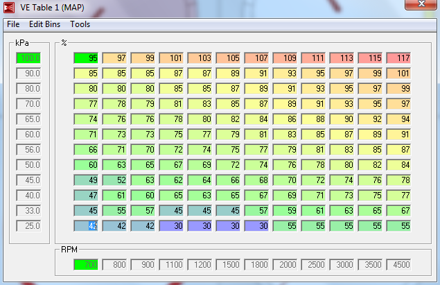

VE Map from MS2 (best tune for performance with bank injection)

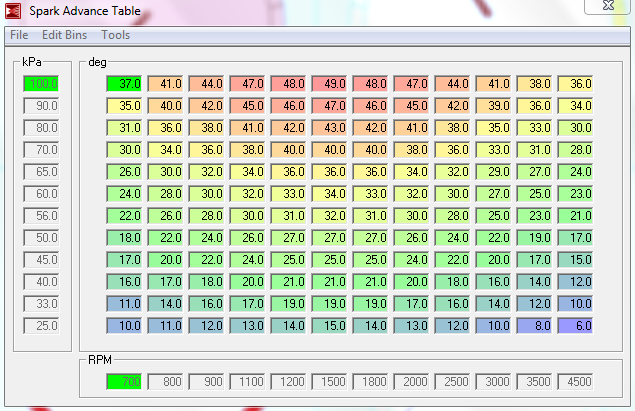

Ignition Map based on GM original ignition tables.
EDIT: the spark advance table is incorrect see the .txt file in the next post for the correct timing information... 03/27/2012

Here is a text file with the original GM ECU tables.
[The extension txt has been deactivated and can no longer be displayed.]

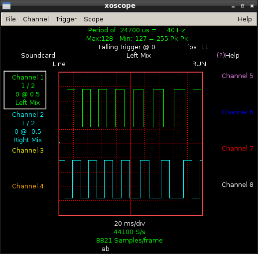

- Posts: 579

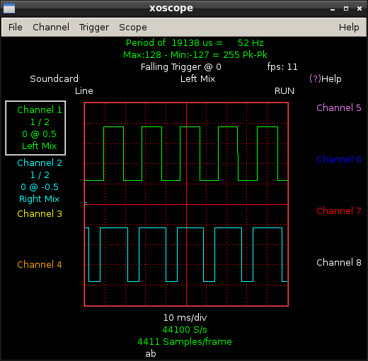

Re: Engine #11 Andy's 1996 GM 3.1L V6 in a 1932 Ford Coupe
Here is the waveform after inverting the EST signal coming out of the XOR.
Green trace is Reference Pulse into FreeEMS, Blue trace is EST from FreeEMS.

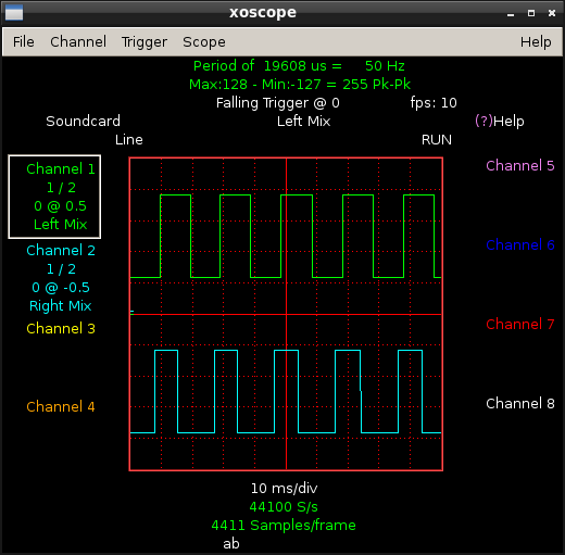

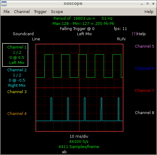

- Posts: 579

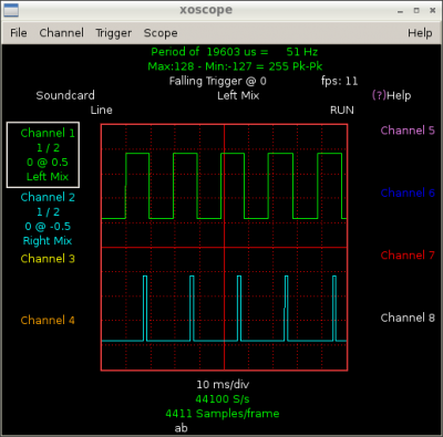

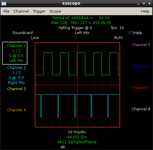

Photos from my testing today...
Here is the first round of testing with changing only the dwell.
After the dwell was increased to 15000 the engine became harder to start and rocked violently.
I also included the baseline factory TACH versus EST waveforms...
Notice the 1500Dwell_0Offset.png the EST signal is inverted...

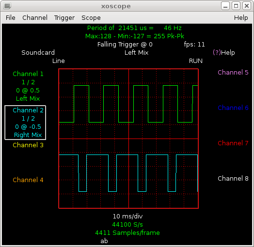

- Posts: 579

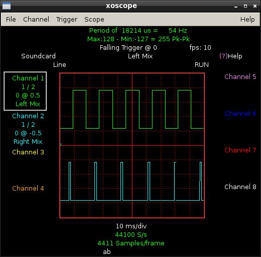

After inverting the EST signal, here is what I have come up with...
For these only the dwell has been changed.
Timing light shows 14* advance versus MTX 10* advance.
I believe its been fixed, but before anyone tries to copy it, lets place on record that that spark table is about as wrong as its possible to be.
