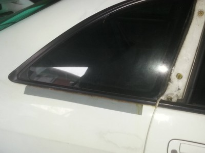

It needs some rust work ASAP. Both the rear quarter windows have rust appearing along the lower edge, especially the drivers side. I'm dreading cutting out the glass and finding out what is hiding beneath but better sooner than later. You can see my dodgy patch job to keep the rain off after I had a look under the paint.

Re the rust, as you know, you have access to both my MIG and my forearms (for the MIG!) so I suggest you sneak it through a WOF when you can, and then we tee up a day to bring it around here, whip the window out, grind up the minor mess that's hiding in there, make up and MIG in some patches, and get some zinc on there to stop the corrosion.
At that point you'll need to get some proper paint made up and then slap it on. So you'll either need to limp it home without the window, or displace the KP60 and leave it here. I guess home with a gap is the best option unless there is a torrential downpour. Once the paint has had some time to set and harden you can urethane the glass back in and put the trim back on. Pain in the arse slow process, so you may as well do both sides the same day, one first, then the other.
I'd suggest waiting for a sunny Saturday/Sunday to do the work around here :-) We can make it a little working bee and I can pull apart, grind up, weld up and zinc prime some bits of the KP, too.
