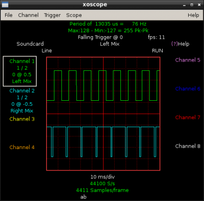

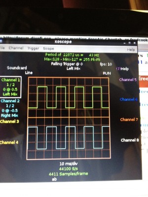

3x Reference Pulse Input to MAX9926 versus Output from MAX9926 via xoscope.
Edit: uploaded correctly rotated photo.
Correctly rotated photo

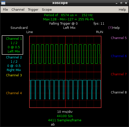

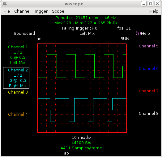

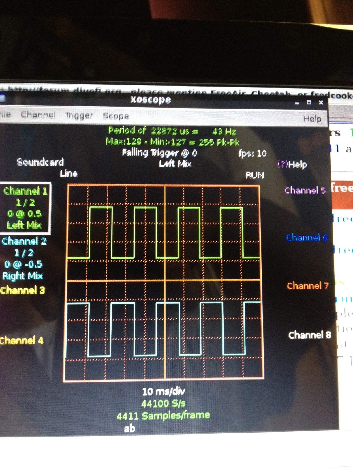

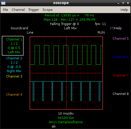

Here are some screenshots of Reference Pulse (Green Trace) versus the EST signal generated by FreeEMS (Blue Trace) at just off idle and revved up to about 2500 RPM.
It was easy to start and never died until I turned the key off :-)
Video link: http://youtu.be/f8b5pIj4z0M
Original factory ECU controlling DIS at Idle
