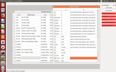

I do some testing just now, 282 and 285 Scavenger s19, still same issue.
It is normal firmware metadata is blank?
This happen when Ardstim set rpm to 1100.
-crank sync never be green
-cam sync, last timestamp valid, last period valid blinking red green red green
-which input was last changing 0,5,2,1
-UId reason changing 2,1,2,1,2,1
-where in the input pattern sync was lost changing 6,3,10
-where the input pattern sync was record changing 4,10,11

Meta data and tracing would depend on matching firmware and EMStudio - chances are you don't have them in sync.
Only the hacked-by-Fred-and-Rob version of EMStudio is worth using, prior to that it was buggy as hell and divergent.
I can't even remember if it's backward compatible with the firmware you've been grabbing, or not.
Crank sync never green is normal for this decoder, it doesn't produce crank sync, it skips it. Some decoders do both, others only do crank, others like this only do cam.
Not sure about the precision/correctness of 4/2 on ardustim. If you link me the data I could compare with my notes and let you know. JimStim is or was definitely wrong though, as is MS firmware which was designed against it. Fail.
Also not sure on polarity vs reality for the ardustim vs the CAS. This absolutely matters - you will not get sync with wrong signal polarity, ever.

Got it sync with Scavanger firmware! I change CAS with another, and got it sync even cas is turning with finger.
So, 4/2 slot type (currently I using at car) and 4/2 opto is different angle?

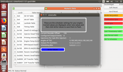

Meanwhile, Movement Control Order extended to another 2 weeks. I looking at the code, and do some edit (Scavenger config) for getting sequence injection/batch ignition.
And the result:- Few question:
1) What is AN AF Table is?
2) Is it ok TPS close is at !6% opening in Emstudio?

AN = Alpha N
AF = Air Fuel (I think, it's been a while)
TPS = you can configure upper and lower bounds for it - maybe using EMStudio, but not sure if the version you have, or not. Then it'll read correctly and log usefully
If you're turbocharging your engine you probably won't need/want AN AF - it was never fully developed though I have driven a few cars on that code. Speed density is best in most cases.
