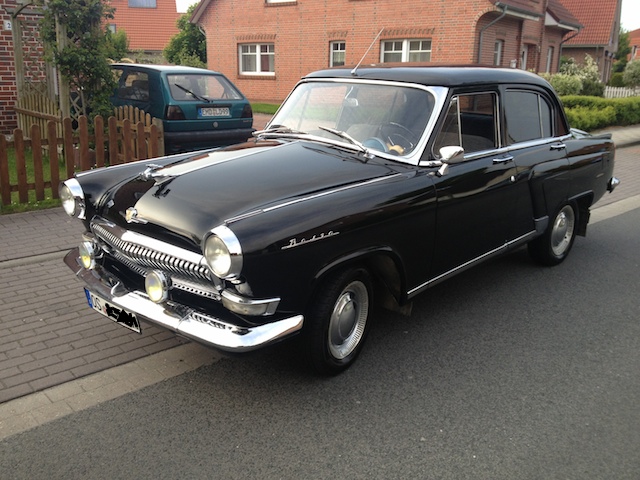

Fred wrote:
I highly recommend driving an old car some time, just for the experience :-)
Really ! are serious ! OK ! actually i do quite often .. but only russian ones LOL :lol2:

I was serious, however it looks like you just have a vastly different style and preference. So be it.
