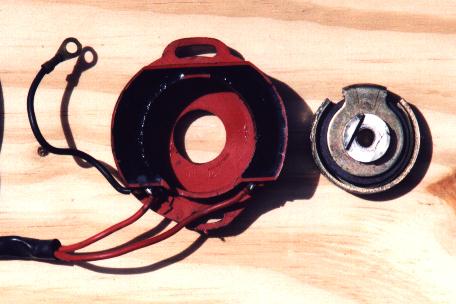

Sounds feasible then.. its a 500cc four stroke (1980 Moto Morini). I'm going to open up the cam sensor and try to figure out how it works. It was one of the first bikes with a semi-electronic ignition. Currently coil power is provided by magneto, that would have to change.

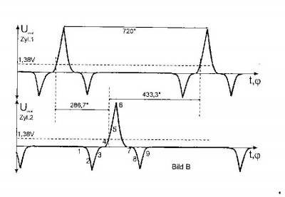

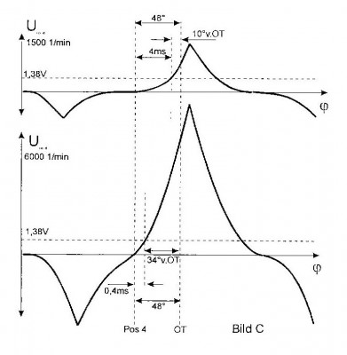

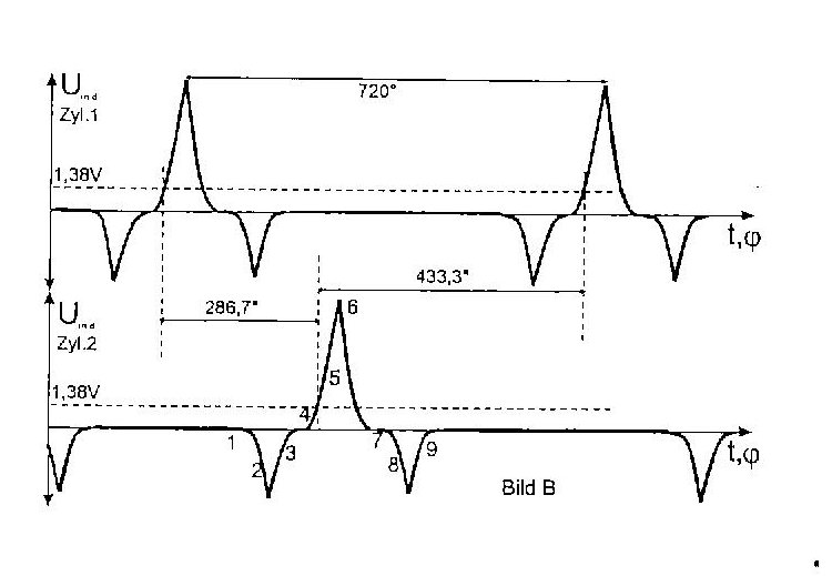

Seems all the work has been done for me. The pickup is magnetic, the advance is driven by a circuit in a transducer which contains a 6 volt coil. The  advance curve is also documented. The trigger is at 1.35 volts.
