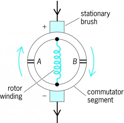

Commutator is no good because no one will know what you're talking about ;-)

A "commutator" is a component in a DC electric motor. It is a two-piece slip ring that switches polarity of the armature based on angular position. "Ignitor" is definitely the word you should use.STC wrote:Pictures are good, but I am lazy to draw
