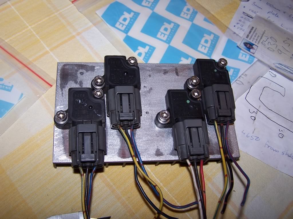

There are heaps of good OEM parts that you just need to throw on a heat sink. J701 units are found on many mazda and mitsi vehicles and are pretty much indestructible. The part in bold is always a good idea! :-)
Re: DIS Coil Pack Ignitors
J701 ignitors on a heatsink :
Very similar J121 ignitors close up. The difference is only the plug, the older square plug is much less reliable and breaks.
