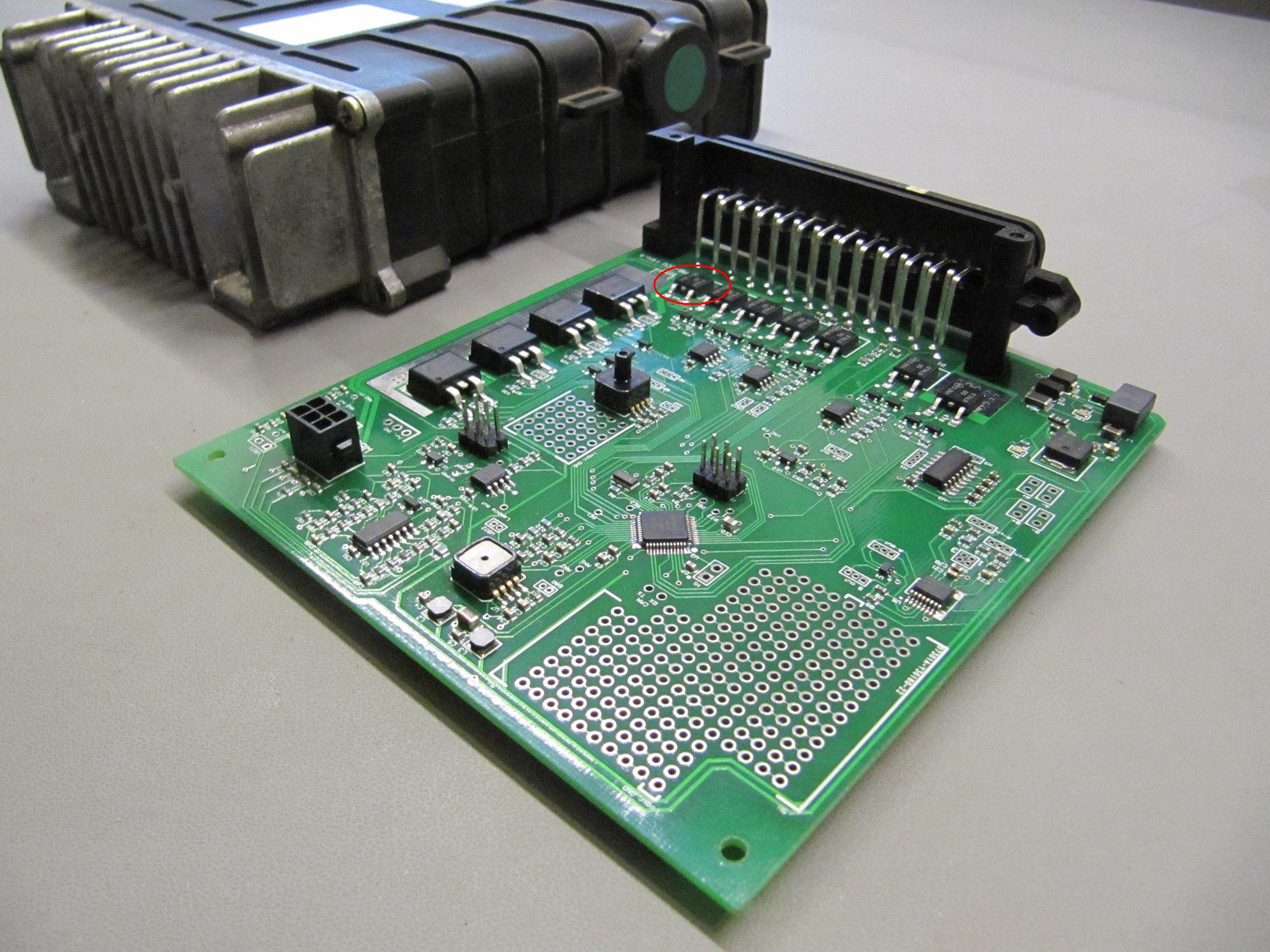

An N-FET driving an average of about 1A in PWM mode does not need heat sinking at all with its exremely low on-state Drain-Source resistance.
But for good practice it's a DPAK with a solid dual-layer-pad with heat transfer vias. I'm using the same footprint for all my DPAKs on the board of course, and I have drivers that source a lot more current than the heater driver.

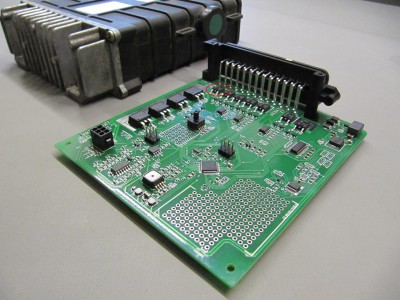

Here's a picture of the unit.
The Sensor heater N-FET is circled out :-)

tmbryhn wrote:Here's a picture of the unit.
Very nice board! It is your DYI ECU-s? Can you take us more info about this? I think this ECU maked for VAG ECU-s replacing? (I see typical VAG ECU enclosure on a photo).
