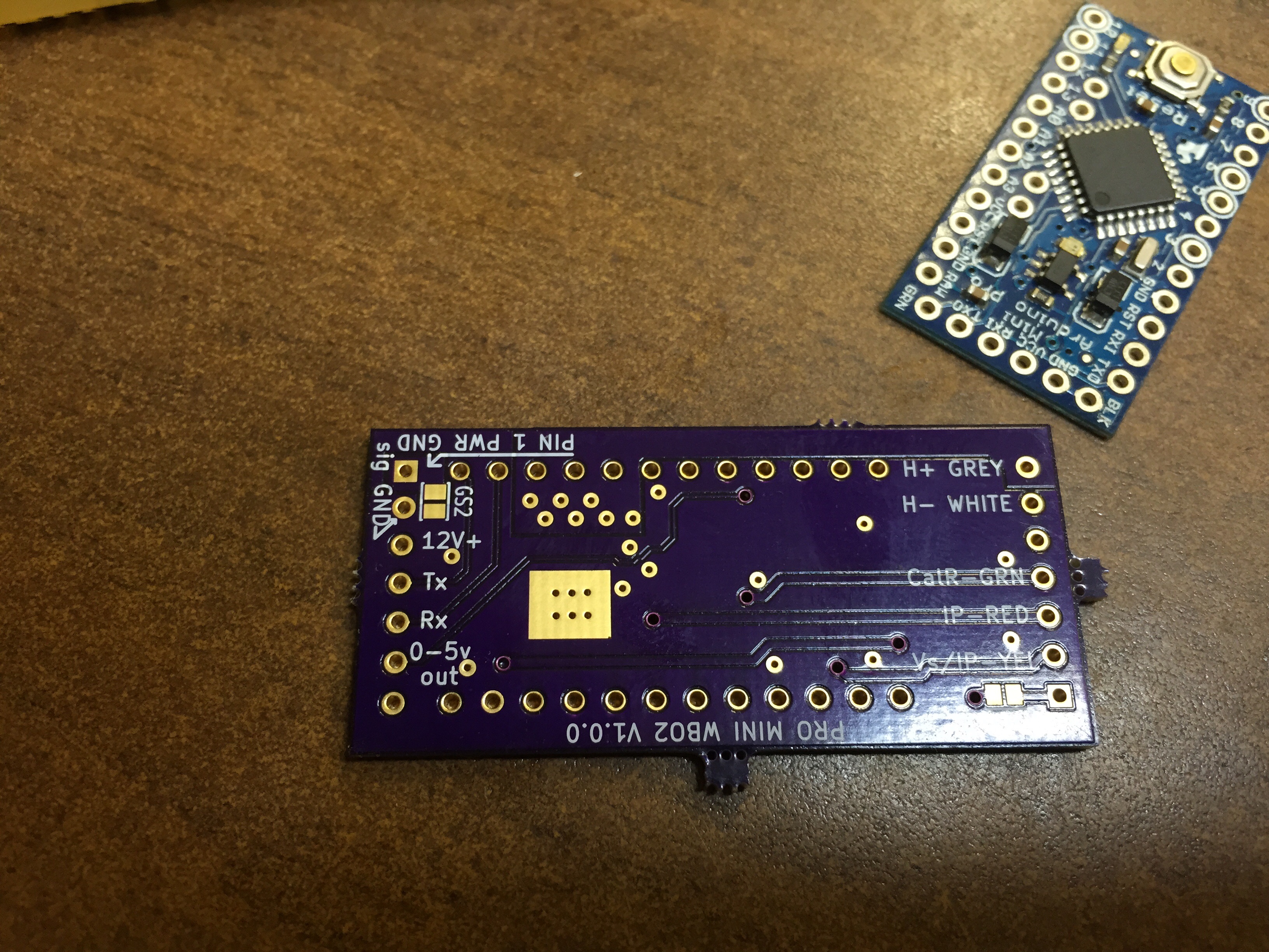

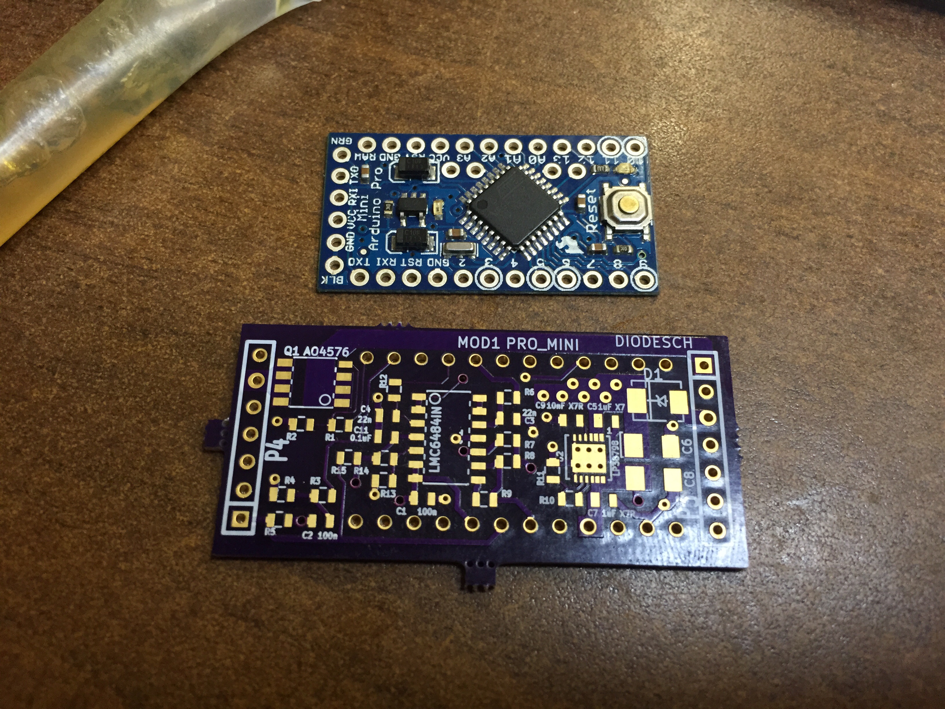

Went on vacation for a couple of weeks, so haven't made much progress on this project.
However the first batch of boards arrived while I was gone, I'll include some pics.
Might get a chance to put one together in the next couple of days, I did it backwards from what I should have done I think, I built the small one first when I probably should have designed a larger mostly through hole design, but the small dude just seemed to hold my enthusiasm. The board uses mostly 0603 sized components, those and all but 1 chip are fairly easy to hand solder. The 5volt regulator I chose is a different story though..... It only comes in a 12WSON package ( kind of a PITA ). However it has very good specs, weather it was worth using or not remains to be seen, I tried to keep the digital and analog circuits somewhat separated, but as this design uses the Atmels ADC that is referenced to the Vref it may be fudimentally limited, only way to tell is to test it once it's assembled. I could have just used the regulator that is already on the pro-mini board, however that one has pretty dismal specs and would most likely suffer thermal issues at the higher voltages it will be supplied with.

Sorry, loaded two of the same pic, here's one of the top

Got one board assembled. My plan was to use solder paste and throw it in the oven, but someone at work threw out my tube of past so I had to go old school on it. The voltage regulator was a bear, and didn't align as well as I wanted it to but it does appear to be working, now to wire up the O2 sensor and load some code into the arduino pro mini.....
