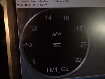

Hi All, I have reassemble my LSU 4.9 controller and have tested it on car. And i have strange results.
I put sensor deep inside exhaust tailpipe of my 06MY Subaru forester, warmed up engine and see measurements while engine idling.
On OBDII Scanner mixture shows lambda 1.0 (AFR is 14.7), but my controller shows AFR 17.2-17.3. And same value i've got while testing on other vehicle.
Is any assuptions of this results? Maybe target resistance of nernst cell is wrong? nernst voltage is about 0.5V
Could you tell me wich values of voltage and current of heater in steady state of your sensor?

Okay, i have found a bug in my mcu firmware, now my controller shows right values for AFR. How it works:
1. Standart heater control with MOSFET and PID regulator. Resistance of nernst cell is measured by pulsing AC coupled signal to cell, than amplifier and peak detector used to measure level of pulse.
2. Nernst control done by relay-control of current:
MCU sends current to pump cell in both direction with current source realized with OpAmp, Nernst voltage feed to MCU's analog comparator, comparator level is set for 0.5V for "positive" current flow, and 0.4V for "negative" current flow. So, mean voltage of nernst cell is kept on level of 0.45V
Then time of "negative" and "positive" current pulses measured with timer and "duty" cycle calculated. This duty cycle shows mean current, flowing in pump cell. Than table search-up made for lambda calculation.
3. Board has an USB interface for PC communication.
