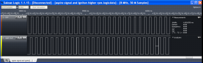

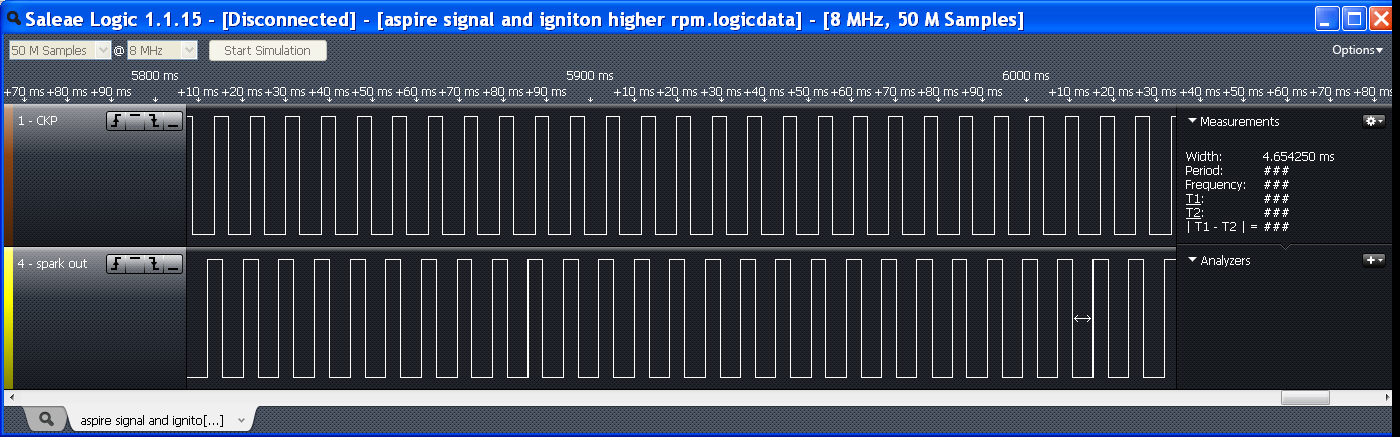

I am trying to understand the communication between my ECU and my ignition module. 96 Ford Aspire (kia/mazda) here - ignition coil is inside the distributor.
With a logic analyzer I see my CKP sensor sends four pulses per camshaft revolution and four pulses on the sparkout wire coming from the ECU. I am hoping to extract ignition advance data from the comparison of these two signals.
What could be the physical sense of the spark out signal? These signals are around 4ms wide. Is it the time needed to charge the coil, and the spark occurs on the level fall? This case the signal is CHARGE/FIRE. I hope it is not something like the Ford EDIS with it's 'advance pulse' protocol.
I've noticed that the pulse width is about 3.7ms in the 1500-5000 rpm range, but it is up to 7ms long for lower RPMs. If that would be just the charge/fire, what would be the reason for the pulse width variation?

both signals in logic analyzer

The curve is of the dwell time. It's not like EDIS at all. The dwell is the coil charging up, and when the dwell ends, the spark (maybe) jumps.
The two things you're seeing there other than the constant 3.7ms section (optimal saturation time with the hardware involved under normal running conditions) are these:
At higher RPM there simply isn't time to dwell for 3.7ms and fire a spark properly for 1 or 2 ms after that, for four cylinders, from one coil. See here: viewtopic.php?f=24&t=48
Mind if I add your chart to that thread?
At lower RPM, below 500 or so your alternator isn't charging much and the voltage has fallen. Lower voltage = longer dwell required for saturation. Below 300 or so, you're still cranking, so voltage is very low due to starter load. Same applies.

Fred, the chart is totally yours!
Thanks for the clarification, I'll go see if I can figure out ignition advance logic based on the fact that the sparkout level fall is my spark moment.
