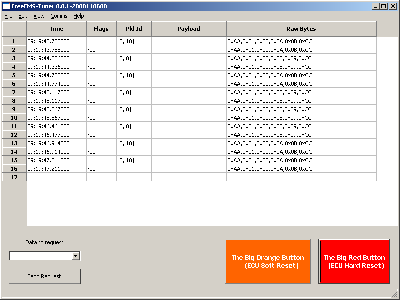

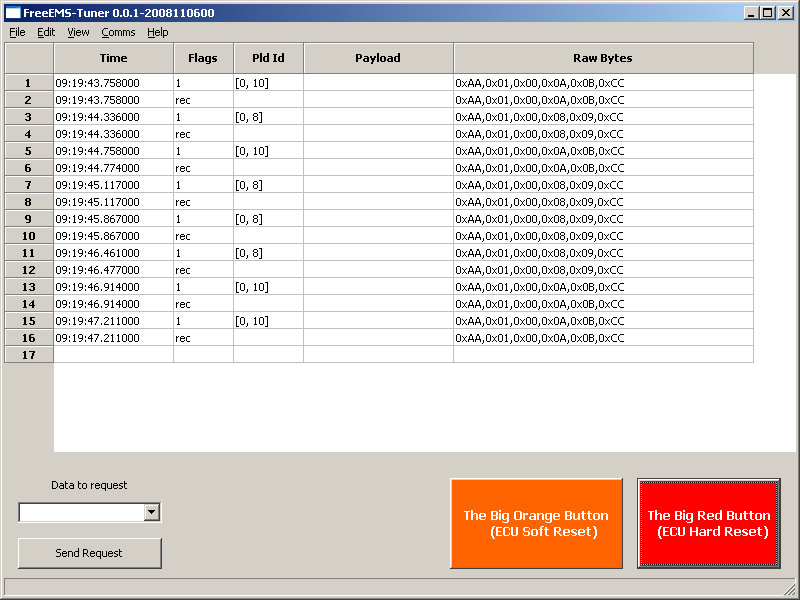

Fred wanted an orange button for soft resets. Going to give it the old college try.
Edit:
No time at all to add the button and such, but took me way too long to find out the Python color stuff. Still didn't find a good way to make it orange... I'm sure someone will set me straight.
Also, the code I added/changed could be done cleaner I know... =/
The two files I changed were "gui.py" and "protocolcs/FreeEMS_Vanilla/0_0_17.py"

Good work :-) I'll give them a try tonight when I get home. Hard reset has been broken for a little while so it will be good to have soft and know that it is soft.

One of things Fred was talking about was improving the packet diagnostics output. e.g. showing ascii output as well as the bytes, replacing the payload id's with the packet type in human readable format.
Or if you are more daring, parsing incoming packets (there are examples of response packets in one of freds latest screenshots).

BTW, orange button works a treat. Red one on the other hand... just screws up the registers lol. Hence the need for the orange one.
