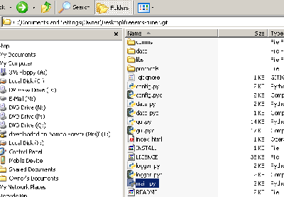

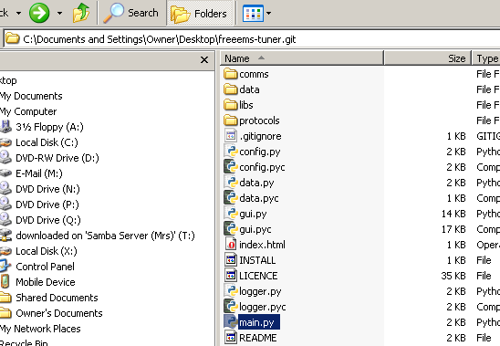

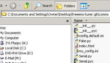

I haven't rebooted quite yet. Attached should be my config files, and some snap shots of my directory structure. Hmmm. Perhaps the spaces in the file name... I originally had it on a network drive with no spaces, then I moved it to my desktop so I could see the shell commands, that
Zip file is because it only allows 3 attachments.

That should work providing config.default.ini is in the root directory (same as README, INSTALL, main.py ...) and my_config.ini is in the data/ directory.

sry_not4sale wrote:That should work providing config.default.ini is in the root directory (same as README, INSTALL, main.py ...) and my_config.ini is in the data/ directory.
Well that seems to be the start of my problem.
To copy the ini file, I copied it to another dir, then renamed it, then copied it back. I appear to have gotten myself messed up, because they are both in the comms dir. Hmmm, not that I do it again on a fresh one, I see the copy and cut are next to each other. Perhaps I wondered a little bit with the mouse click.
I copied the files back to where they should be and it works tip top now. Also works fine in the Desktop with the spaces in the name, so good news there as well.
