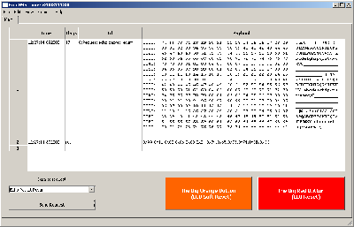

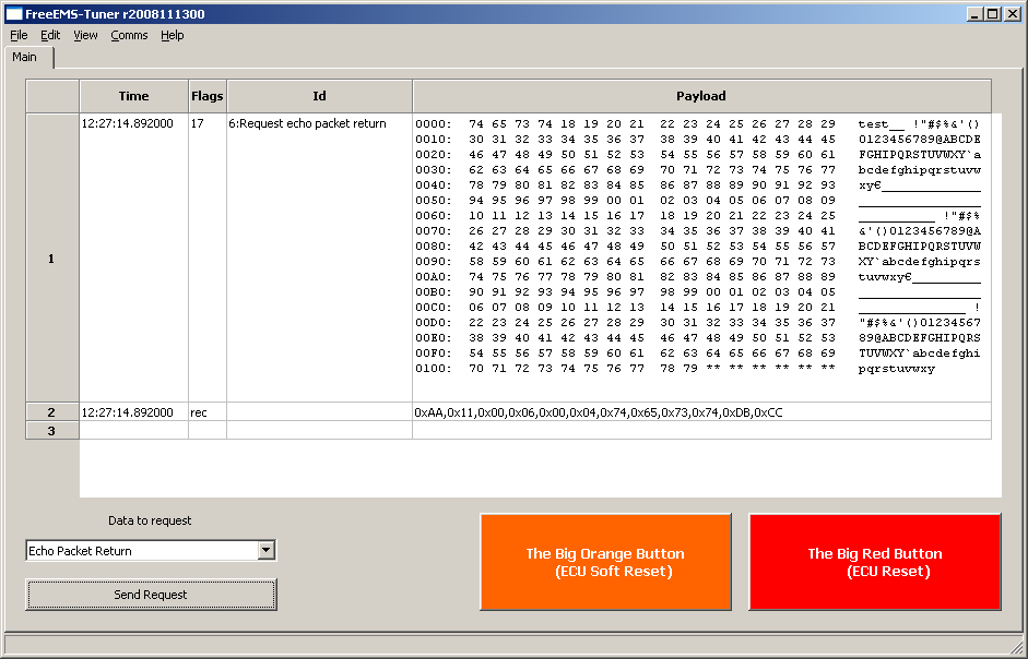

Okay I got the payload hex display thingy finished. I'm going to try and figure out how to post the code using git tonight. For now you get a screen shot and the file sin *.zip form.
Changed files:
gui/commsDiagnostics.py
protocols/FreeEMS_Vanilla/0_0_17.py
I used extra data to simulate that screen shot. You're not going to be able to reproduce the screen shot taken below. Characters that don't translate to ASCII are displayed as an underscore. Hex rows are padded with asterisks.
Edit: Oh, the code is really bad by the way. I'm still learning Python and I know a lot of it could be cleaner. Aaron, do what ever clean-up you'd like.
Changed files:
- Files.zip
- (5.17 KiB) Downloaded 767 times

Don't be afraid to make it all a bit wider as this is just a debug tab at the end of the day anyway.
What I was trying to say is this :
In the flags column instead of the value 17 which is meaningless even to me and I set the flags up lol.
IsProto : 0
HasAck : 0
HasLength : 1
HasAddrs : 0
IsNack : 0
spare1 : 0
spare2 : 1
spare3 : 0
Re: Ben's messing around with FreeEMS-Tuner
Perhaps upper case ON and OFF or YES and NO instead? or perhaps 0 and 1 are best :-)

Fred has pointed out a problem with the red button in my screen shot. It should say "(ECU Hard Reset)" not "(ECU Reset)". Somehow either that change never made it into the master repo, or I've fudged something up. Aaron, seems like a real quick fix for you if it is indeed wrong in the master repo, which I'm betting it is.

Ben, from the docs :
Header Flags
Bit 0 - Payload type (protocol/firmware)
Bit 1 - Acknowledgment valid and/or required
Bit 2 - Acknowledgment type (-ve/+ve)
Bit 3 – Has Addresses
Bit 4 – Has Length
Bit 5 - Firmware implementation specific
Bit 6 - Firmware implementation specific
Bit 7 - Firmware implementation specific
And the code :
Aaron :
Won't that create more work for you, or at least keep it the same?
I guess a bit of communication will keep it minimal though, just a thought.
Header Flags
Bit 4 – Has Length
And the code :
