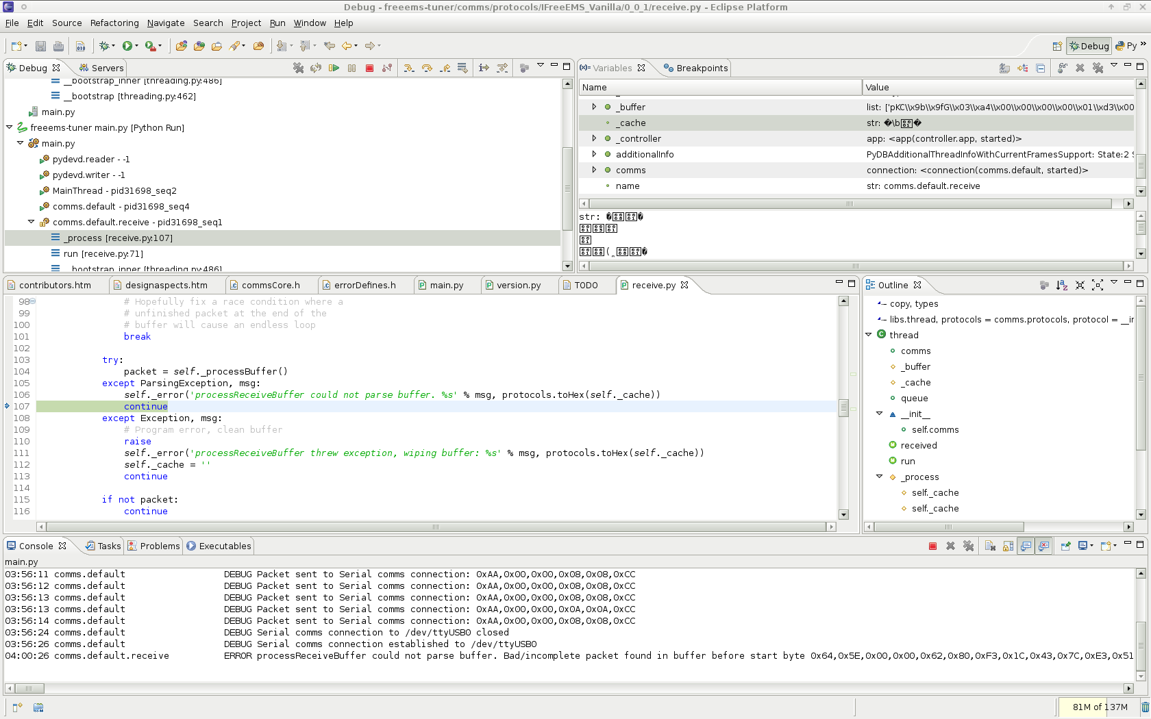

01:37:21 comms.handleReceivedPackets DEBUG BasicDatalog packet received and processed
01:37:25 comms.default.receive ERROR processReceiveBuffer could not parse buffer. Unescaped bytes found in packet: 0x08,0x01,0x91,0x00,0x60,0x63,0x33,0x64,0x5E,0x00,0x00,0x62,0x80,
LOL, the next MASSIVE block up says this :
01:37:21 comms.default.receive ERROR processReceiveBuffer could not parse buffer. Checksum is incorrect! Provided: 4, generated: 98 0xAA,0x08,0x01,0x91,0x00,0x60,0x63,0x33,0x64,0x5E,0x00,0x00,0x62,0x80,0xF3,0x1C,0x43,
Definitely some filtering going wrong somewhere.
