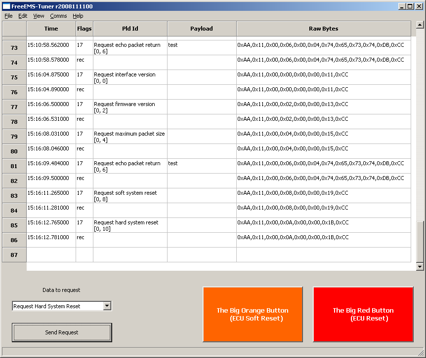

BenFenner wrote:Yah, the code was easy to follow for a python noob like me.
I actually noticed the packet diagnostics output could use some work. Good idea. Sounds like a good next job for me. Let me know when I should download the newest version to start from. (Probably won't get to this until tomorrow, as it's the end of the work day where I live). Also where is the list of Payload ID -> Human Readable Name? Fred?

Ben, the docs are available now, as is the source code.
Another thing worth doing is mapping error codes to error descriptions for display and displaying debug packets data as the plain text it is.

Post by BenFenner »
I see the __init__.py files now... Maybe I just had a brain fart and missed them.
Anyway, on to the human readable names.
Look about right?
commsDiagnostics.zip
(1.5 KiB) Downloaded 666 times

Post by sry_not4sale »
Thats great, can you removed the bytes underneath the names? And rename the column to just "Id"?
Good work!

Post by BenFenner »
sry_not4sale wrote:Thats great, can you removed the bytes underneath the names? And rename the column to just "Id"?
Done (see attachment).
sry_not4sale wrote:Do you know much about patching and diffs?
I know all about diffs... Patching, not so much. I assume we're trying to find a way so I don't have to post code here anymore?
(1.49 KiB) Downloaded 683 times

Post by jharvey »
Ohhh, I like that human readable stuff.

Post by BenFenner »
I've got the changes made. Now I just need to figure out git so I can commit them. Here I go!
Edit: Git is a pain in the butt. I actually managed to "clone" the repository, but I can't "push" to it. Maybe that's by design?
Here's the recent changes anyway:
gui/commsDiagnostics.py
protocols/__init__.py
Files.zip
