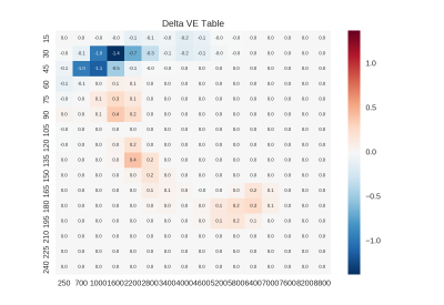

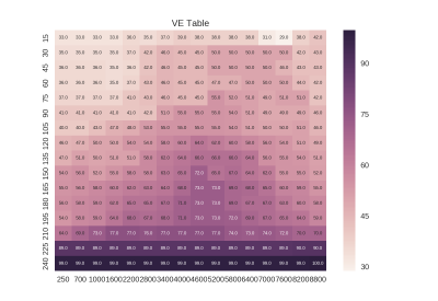

Hacked the script to look for LR() instead of AP() and got this:
With this difference:
On the first run I fed it tables from the wrong checkout/base tune. The script didn't seem to notice that the base table was different from the table within the logs. It should probably check and warn if the log is for a different base tune.
Very cool tool! Will chuck through some longer logs when...if I ever get some.
