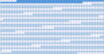

I am trying to implement a small application capable of reading and displaying information from a FreeEMS and hopefully capable of speaking to it. Something along the lines of EMSTune. My Development board arrived recently and it just required changing the permissions on ttyUSB0 and was ready to go. I initially did something other than the required:
Baud Rate: 115200
Data Bits: 8
Stop Bits: 1
Parity: Odd
And hence I was getting garbage, I think... After getting advise from DeuceEFI about the correct settings, I was able to do the capture I've attached to this post. I wanted to see if we can use this post to come up with documentation for the protocol so that others like me can enhance the potential of FreeEMS via applications that connect to it.

According to what I read(I may be wrong, please be patient), the following is a complete packet:
AA 01 01 91 00 62 B7 CB BA 0D 03 6B 41 80 04 47 04 69 01 37 B7 CB 00 0C 00 0D 00 06 00 00 00 00
00 00 00 00 00 00 04 47 38 00 80 00 01 32 84 54 00 91 53 33 00 00 00 BC 0E 36 0E F2 00 00 47 0C D6
00 00 00 00 D0 00 00 00 00 00 00 00 00 12 00 00 00 00 00 00 00 00 00 00 00 00 00 00
00 00 00 00 00 35 19 A8 CF 00 00 F3 CC
If we break it down we get:
0xAA : Start of packet
0x01 : 7th bit is on. I know Bit 0 - Has Length, Bit 1 - Is Negative Acknowledgment, Bit 2 - Has Sequence. What are Bit 3, 4, 5,6 and 7?
0x0191 : Basic Datalog packet???
0x00 : Mode Stop
From what I've read so far, I don't know how to interpret the following stream:
00 00 00 00 D0 00 00 00 00 00 00 00 00 12 00 00 00 00 00 00 00 00 00 00 00 00 00 00 00 00 00 00 00 35
19 A8 CF 00 00
F3: Checksum
CC: End of packet

Bit zero, not bit seven, is 1. Bit seven is zero, as are bits six through one. This is your mistake. No idea what you mean by "mode stop" that's purely erroneous. 0x0062 is hex of 98 which is packet body length.If we break it down we get:

That's because it's configurable. Look at the struct definitions and the data log definition in the configuration of the device. This is your meta data, for the time being. Use your favourite scripting lang to parse these things into a usable format and use it.From what I've read so far, I don't know how to interpret the following stream:
62B7 CB BA 0D 03 6B 41 80 04 47 04 69 01 37 B7 CB 00 0C 00 0D 00 06 00 00 00 00
19 A8 CF 00 00
F3: Checksum
CC: End of packet

Can you be more specific, where can I find these structs?That's because it's configurable. Look at the struct definitions and the data log definition in the configuration of the device.

http://builds.freeems.org/firmware/dev/ ... ource.html < some of them
http://builds.freeems.org/firmware/dev/ ... 9ec83.html < data/config
http://builds.freeems.org/firmware/dev/ ... tml#l00160 < in particular
Pero normalmente lo suficiente, entonces me la pela! :-p Mejor? :-D
