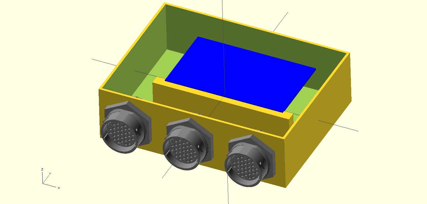

So i had an idea of making a waterproof ecu case, that can be 3D printed (and cnc milled in long term ? maybe)
The case secures the jaguar box with a slide mecahnisme and a block on the center that screws on top. Not finished yet.
For connectors instead of using a wire to board big connectors, i went with the Molex XRC connectors allowing panel like mounting, the connectors itself are IP67 rated, and offer a gasket option to make the assembly tight.
There is still a lot to do! But this shows a good idea of how it is gona be already. The box itself Overall list of stuff missing
- Mounting options for the case
- Complete jaguar mouting
- Add waterproof usb connector mounting
- Design waterproof bead between top and bottom
- Add the FreeEMS logo on the top of the case if fred allows
The CAD software is OpenSCAD if you're a programmer, you will feel right at home.
Please if you have any sugestions use Github issues or this thread.
Beware the code is very rough !
