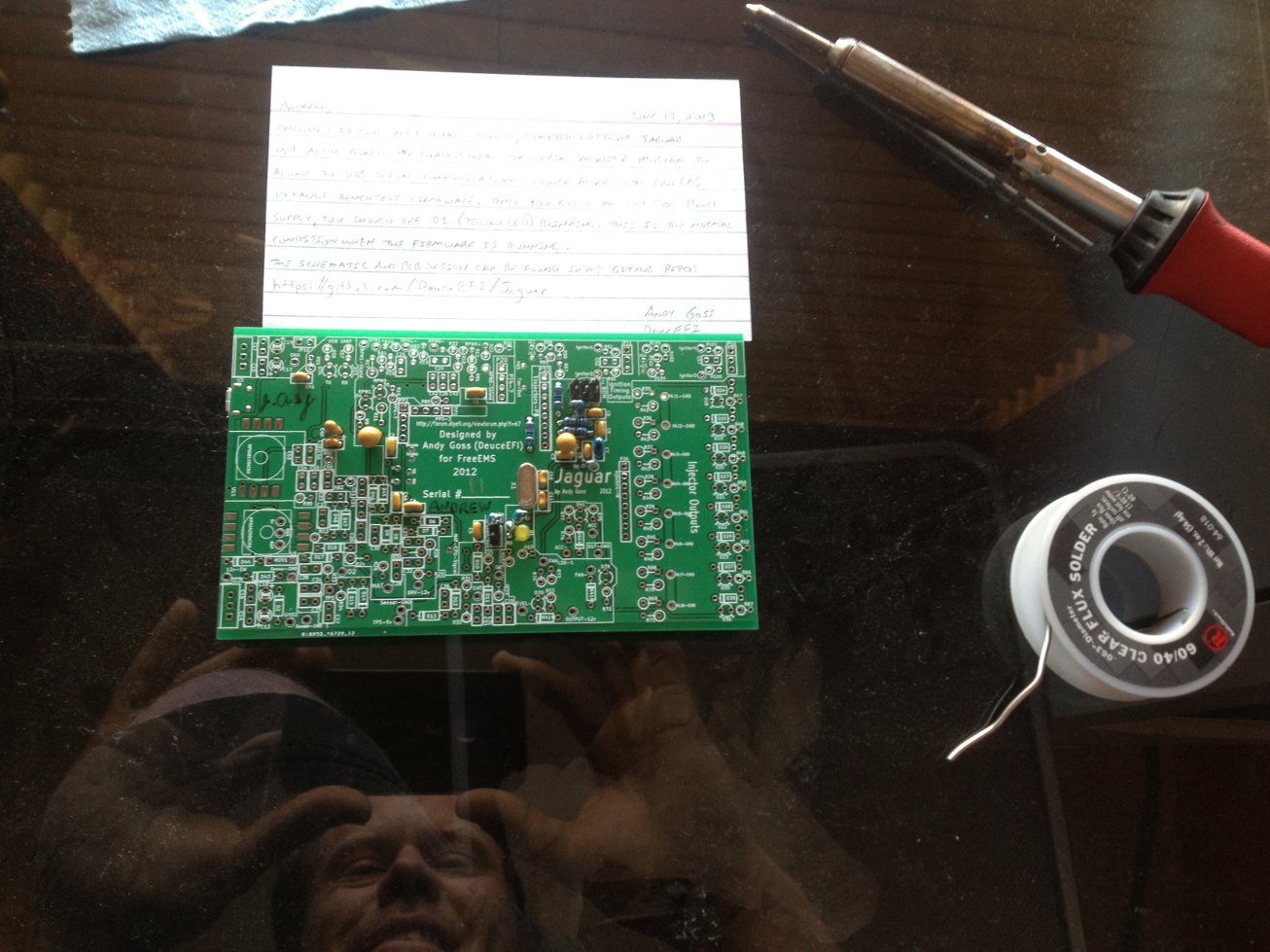

The board has arrived. This is the first of the creepy semi-reflective picture line. At least you can see I'm happy. By chance I got serial number 11. Very nice touch with the handwritten 3x5 card. I hadn't realized how small the PCB would be, since I was looking at the preview pictures on a 24" monitor. By the way the solder job by DeuceEFI is tits! Will my .063" 60/40 clear flux solder be sufficient? Only time will tell. Tracking on the component order isn't posted yet, so probably mid-week I can get started.
Re: teaser car 25
No, pick up some 0.7mm wire or you'll have trouble. 0.5mm is a pain because you have to feed it a lot. 1.0 is too big, but barely usable in a squeeze, 1.6mm is HUGE and not useful.

Thanks for the advice Fred, I'll pick some up.

I used 0.032" diameter 60/40 rosin core solder to mount the components to the board, Radio Shack part # 64-005 E
I also used MG Chemicals Catalog Number 8341-10ML No Clean Flux Paste for the surface mount components in addition to the above solder.
