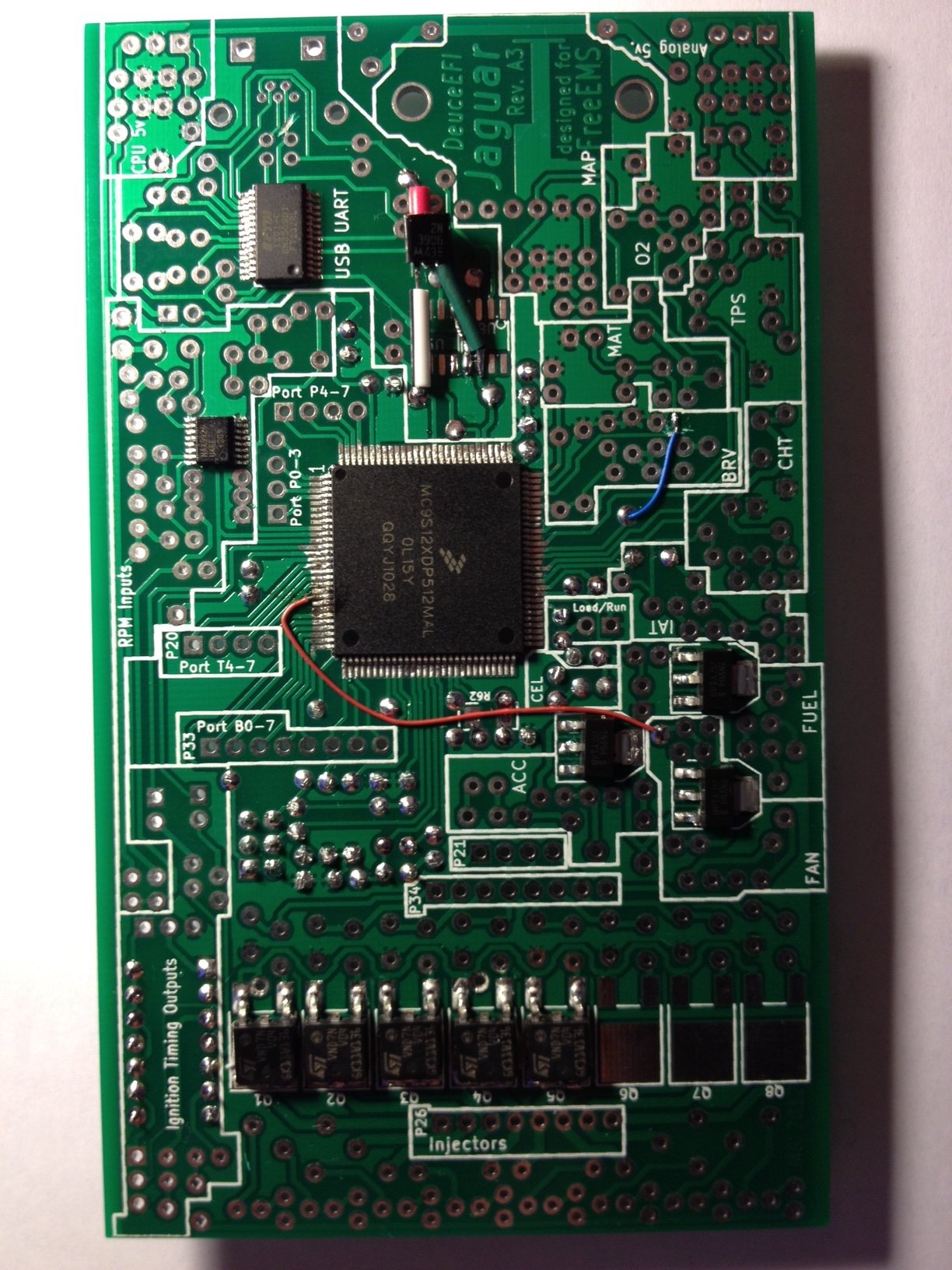

Ok, the much awaited photos of Hentai's Jaguar board are here
Hentai:
Connect your MAF output to the solder pad called MAT, I have redirected the output from that circuit back to the MAF-Signal pin on the MCU with the blue jumper wire.
The red jumper wire is so that you can control a radiator fan based on the existing freeems-vanilla code.
The white jumper wires are to bypass the opto-isolator circuits (which don't work) and the 2N2906 PNP transistor modification has been done to allow the current Serial Monitor program to run when the USB cable is disconnected.
If you have any questions use #freeems so that we can help you in (near) real time.

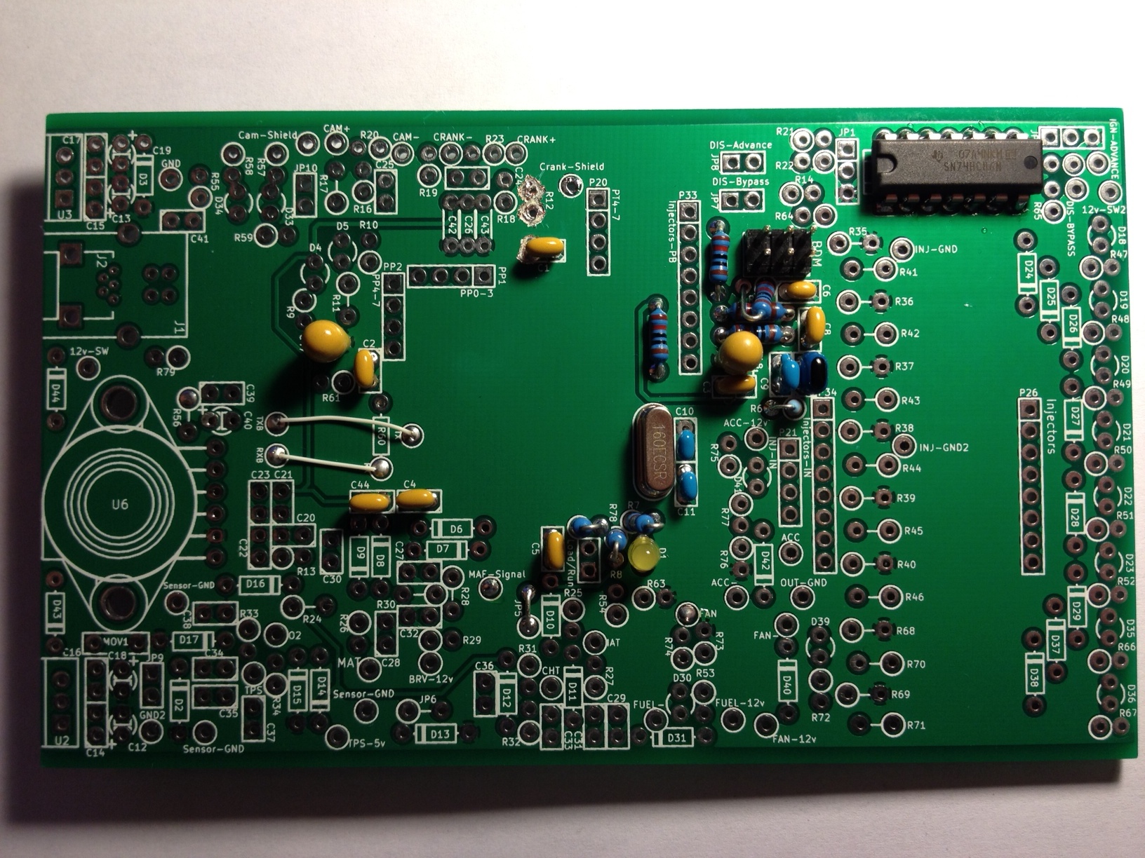

Hentai,
Here is a photo of your very own limited edition, signed and serial numbered Jaguar A3 board.
