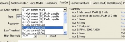

Except for MS, the only other ECU I've used is an e420c from Adaptronic.
The configuration software for the e420c ECU is called WARI. You can get a copy to play with, from the web site.

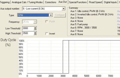

For outputs you first selected the output number. The text in the pull down list tells you the current limit and if they are PWM capable.
Then you choose what the output type. For type RPM we can then set high and low values for the hysteresis. Note PWM check box greyed out because its not available for output 6. Also, the "configure" button is greyed out because there are no other configurations for selected type.
Continued next post.

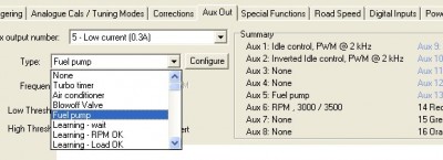

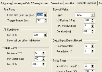

When you select a standard type like "Fuel Pump" the configure button becomes available.
Pressing "Configure" takes you to the "Special function" page where you can configure these standard functions.

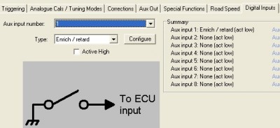

Selecting Inputs is similar the the Aux Out selection. First choose the input number than select the type. Standard types such as the Enrich/retard function are also configured on the "Special function" page, as shown above.
