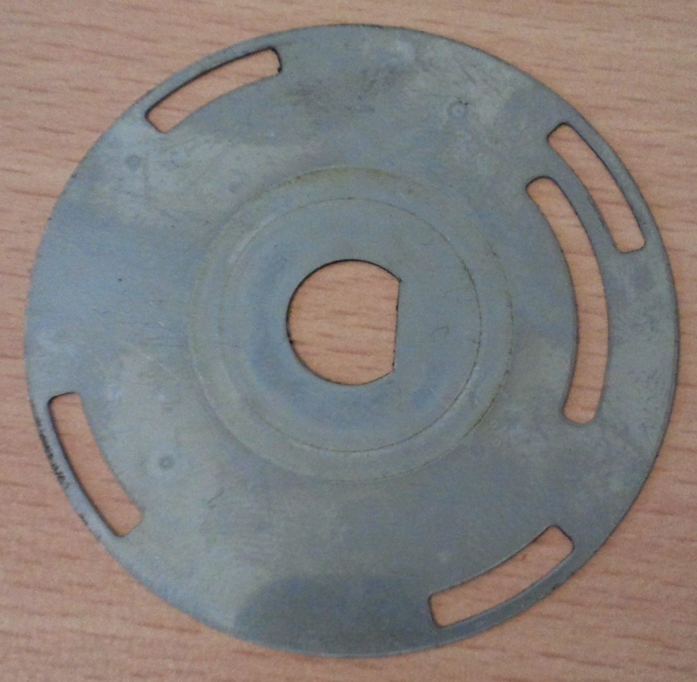

Today I had fun trying to find a cas wheel.
The following engines all use the same 360-4 CAS wheel that I have. Nissan RB30, VG30, GA16
The only luck I had was from a 1990 Mitsubishi Galant
Will this do?

Yes it will! :-)
That's exactly what my truck has in it and what it was running from in all of the videos of it on youtube. I have bench testing here for it and can test your configuration for you before you try anything. If you want to get better resolution later there are lots of options and you can use that disk as the pattern to have custom ones made.
Will you be using this with the optical sensor out of the Nissan? If so, i'm VERY interested in how it behaves once you can get us an RPM reading from it in some fashion.

Be a good idea to test it out before fitting into the engine. I have a drill that will do 5krpm that has a chuck big enough to fit the shaft of the dizzy into it, would make a good test rig.
But with out FreeEMS hardware or a data analyser do you have any suggestions on how to log this data in a useful manner? Or should I just wait till I have the FreeEMS hardware ready as well?
Sat Nov 05, 2011 2:56 am
Posts: 15162
You can just wait, no problem there.
If you really want to, you can use a sound card input to log that CAS. They just pull to ground, so you can supply the cas with 9-15 volts and put a weak 5v pull up on each output line and feed it into your line in. That will saturate the drivers, but shouldn't damage them. Pull up to a lower voltage if you're worried. on linux there is xoscope, unsure about windows, unsure what you're running! :-)
For that test to be useful the rpm needs to be pretty steady with very little mechanical jitter. Also, btw, 5k on your drill is 10k engine speed :-) The lower and steadier the speed, the better that test will be.
Another way that you could do it is at zero RPM with a protractor and a couple of LEDs :-) It's up to you, if you want to experiment and provide some interesting and unique data, go ahead, if not, it can wait.

xoscope looks like a great solution. Worried about the stability of the wheel and sensor readings at higher RPM's, not concerned about the code side. Feel the need to test the CAS solution before it goes in an engine so I know it behaves correctly.

The stability of the setup will entirely depend upon the drive from the crank to the cam and from the cam to the disk. If your drive to the disk is tight and smooth then it will be tight and smooth also. Worry about the engineering side of it, the opto sensors are rock solid in my experience with them. The code should be fine to a very high RPM - I tested it to 8000, though.
