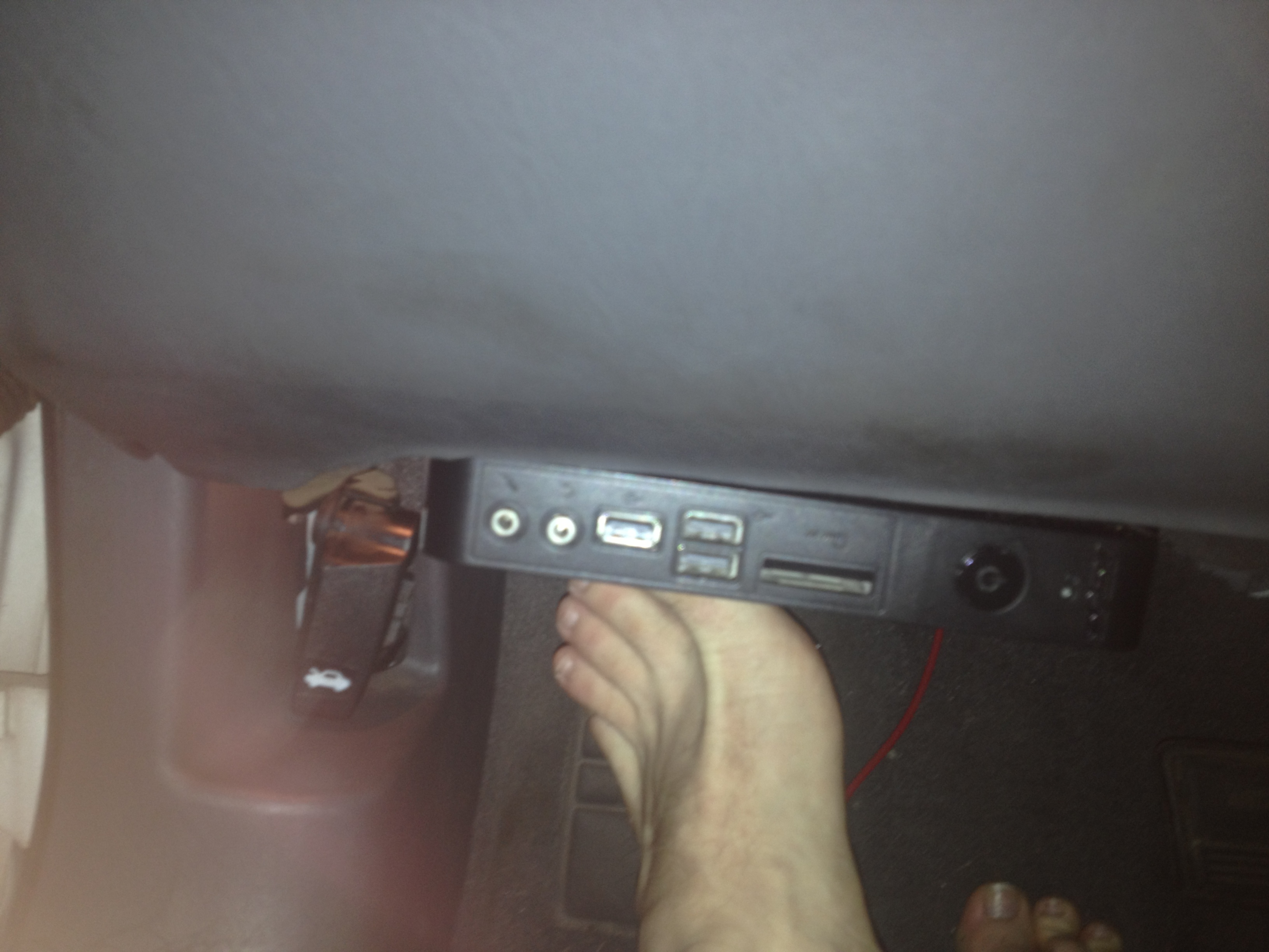

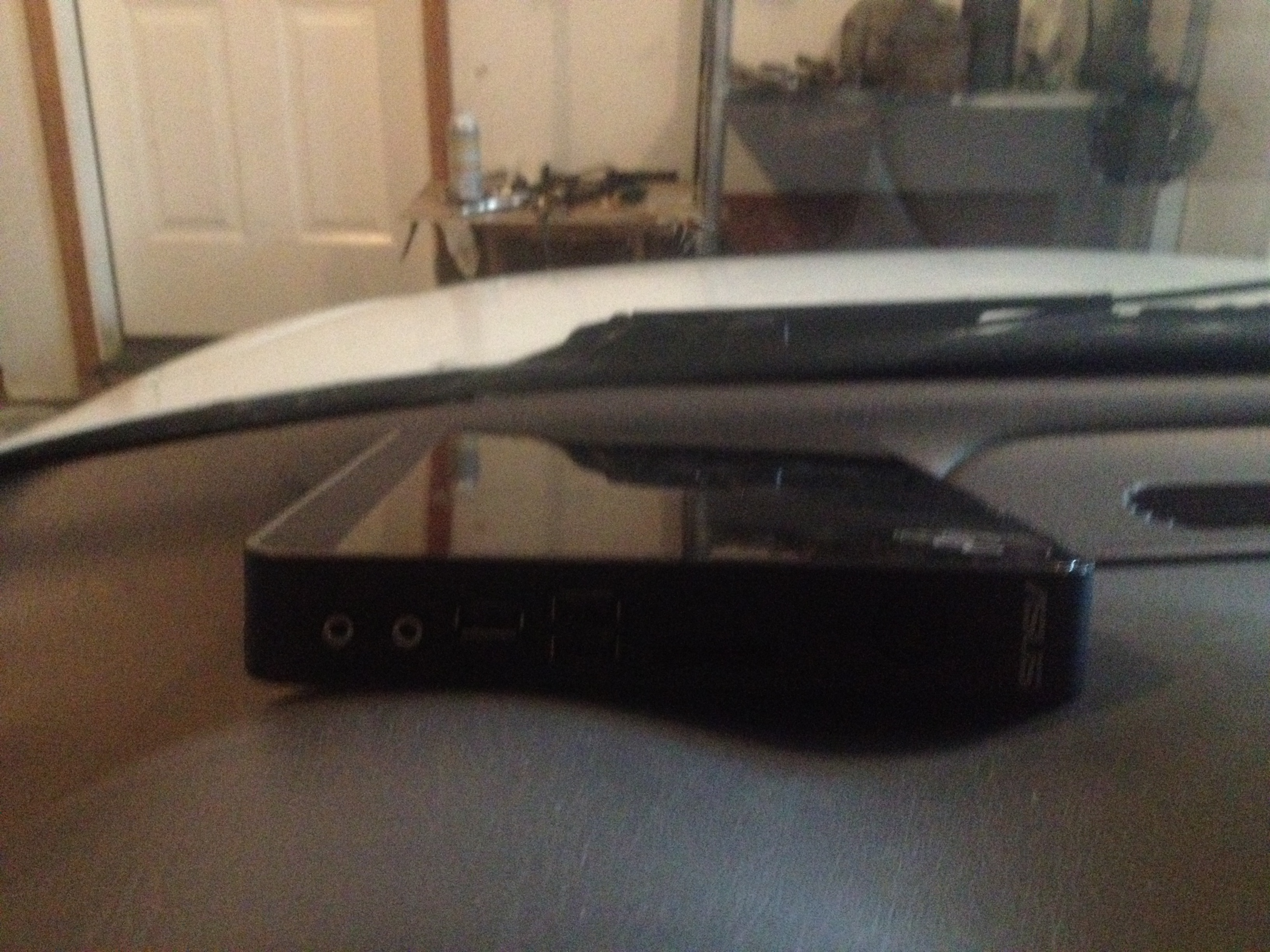

OK, so beginning to plan the infrastructure for the car, since hardware is starting to appear. Here is the beginnings of the 'logger/interfacer'
Eee
I have 2 of these machines. One might be a higher spec, currently running windows 7 Home premium. This PC will have an iPad connected with USB to enable 4G internet access. This machine will have a VM running ubuntu 12.04 (or 13.04). This VM will have USB pass through for the Jaguar connector. This VM will log as much data as possible. Possibly planning to upload real time data to s3.
the windows host will provide wireless internet access to laptop or anything else connected, including the dash. USB connected iPad with Verizon 4G service will provide internet access to the host which will (likely using the ubuntu VM) provide an internet proxy.

EeePC runs 6 USB ports, eSATA, SD MMC, vga. The other one runs HDMI and moves USB port to front by power button and runs an 'Nvidia ION'. This one would be better for direct attached video, as the video processing is better, and it already runs Windows 7 Home Pro. Both have gb Ethernet, and WiFi
I'm linking the Jaguar 0.5-alpha TODO to monitor progress on the 0.5 version of the board.
