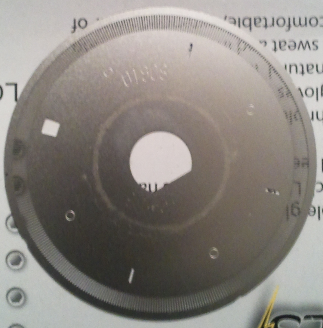

Decided to ditch the 4G64 CAS and found an optical sensor instead. The new CAS is from an Nissan 200sx (SR20DE), Image of the disk is attached. The inner track on the disk has 4 holes, one of which is alot larger then the other three. Next week I will begin modifying this to suit the engine.

More later, but I would not recommend that on a V8, the only usable events on it are the 8 in the centre, and only 5 of those are usable really, and only four make sense to use. The wiring for Nissan style stuff has to be perfect too. The 4g63 stuff has 8 almost evenly spaced edges that would be useful for scheduling from for 8 cylinders. Back later for a more full reply.

The circles in the center are not complete holes, they are only impressions so the optical sensor will not detect them.
So the center track only has 4 holes, 1 square and 3 smaller rectangles. I should have used a better background.

Now isn't later, yet, but I can see it clearly and each hole has 2 edges which can generate up to 1 event each yielding 8 events total. They're all so close together (in pairs), though, that it doesn't matter much, you may as well only have four.

Very confused with your comments. Your saving that the 360 slots in this disc are not suitable for a V8 engine, and fewer edges are better for my application?
I assumed the more data, more accurate positioning of the piston = better engine timing
