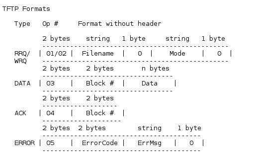

I'm used to looking at RFC's. Protocols normally have something along these lines in their RFCs:
Is it possible for you to define your protocol in this format?
Thank you.
Thank you.
