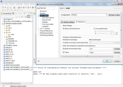

Hi to all.
I am trying compile the "freeems-vanilla-master" with eclipse.
I readed this:viewtopic.php?f=8&t=1618
but eclipse say:
"make -f Makefile all
make: *** There is no rule to build the target `all'. Alto."
Can any help me please?

Re: Users, Please Help The Developers!
Things have changed a great deal since those days. Top level makefile has special targets in it. The main makefile is in src/main now.
Also, please be aware that the latest code is not currently published. Play around with the old public code, but if you are actually planning to run something, consult heavily with us so we can prevent any pain if support for your setup is limited or whatever.
Best bet: start a thread on your target vehicle in users rides :-)
