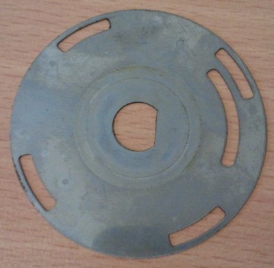

Today I had fun trying to find a cas wheel.
The following engines all use the same 360-4 CAS wheel that I have. Nissan RB30, VG30, GA16
The only luck I had was from a 1990 Mitsubishi Galant
Will this do?
Re: Newbee questions on injected LPG for a 289 windsor
Yes it will! :-)
That's exactly what my truck has in it and what it was running from in all of the videos of it on youtube. I have bench testing here for it and can test your configuration for you before you try anything. If you want to get better resolution later there are lots of options and you can use that disk as the pattern to have custom ones made.
Will you be using this with the optical sensor out of the Nissan? If so, i'm VERY interested in how it behaves once you can get us an RPM reading from it in some fashion.
