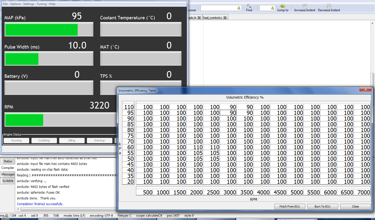

I tried your interpolation function with my firmware and I'm getting some strange results. Sometimes it works flawlessly but other times no interpolation is done. Here is a screen shot of mine where the required fuel is 10.0 and the pulse width should be 9.0, on arduino uno. As soon as MAP goes down to 94 the interpolation works. Any way good luck with your project!

crazyafrican wrote:I tried your interpolation function with my firmware and I'm getting some strange results. Sometimes it works flawlessly but other times no interpolation is done. Here is a screen shot of mine where the required fuel is 10.0 and the pulse width should be 9.0, on arduino uno. As soon as MAP goes down to 94 the interpolation works. Any way good luck with your project!
Thanks for the feedback, really appreciate it! Could you please try the latest interpolation code at https://github.com/noisymime/Kartduino/ ... er/table.h and see if it works any better? If you're still seeing issues, could you please let me know exactly what RPM and MAP values are causing the problem?

Here are the results from the new funtion

That seems to be behaving about how I'd expect. It's certainly interpolating correctly between the 90 and 100 VE values once you reach 95kPa. The weirdness before then is 100% due to the accuracy loss that comes in when you lose the floats (At least, the way I've done it). I've had a play with it tonight and I can improve the accuracy a bit, probably within 1%, but it's always going to be off by a bit unless I find another float free method.
