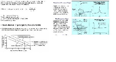

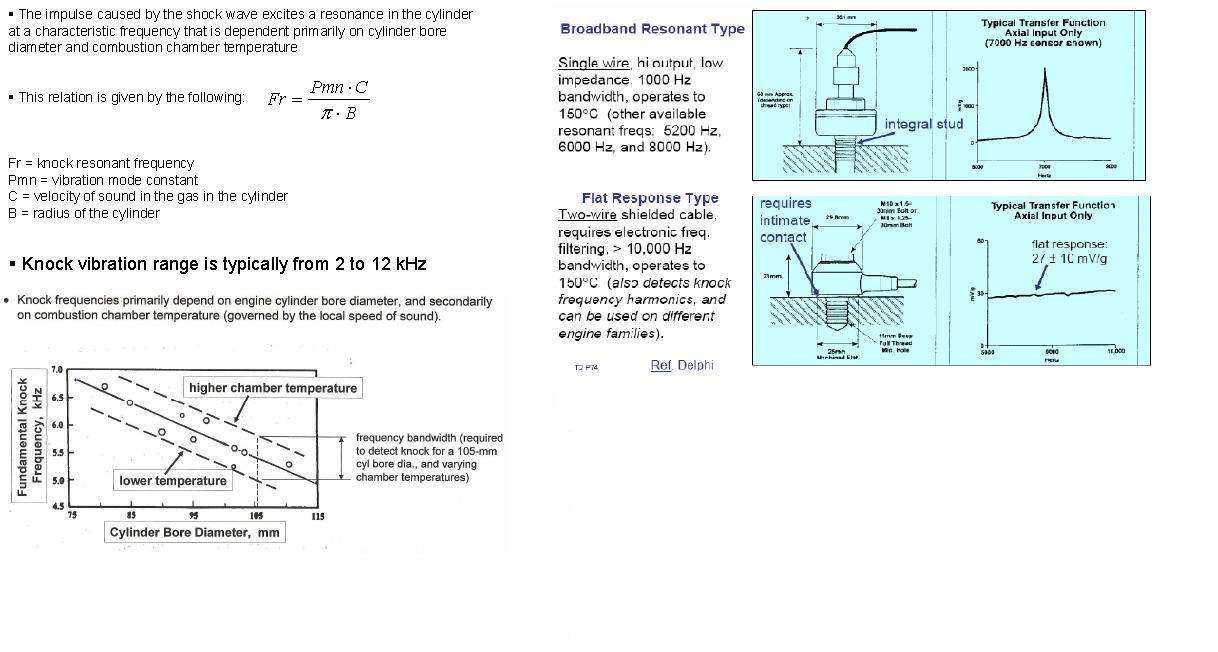

In an attempt to better the process of detection by piezo-electric knock sensor , I implement a band-pass filter. As the knock sensor non-resonant plays virtually all audible frequencies of engine noise, a filter is necessary to separate only the resonant detonation frequency.
The resonant frequencies excited by the presence of knock depend on the geometry of the combustion chamber and the speed of sound in the cylinder charge. These resonant frequencies are typically estimated by assuming an acoustic model for the combustion chamber. For a homogeneous gas filled, acoustically hard walled ideal cylinder, the resonance frequencies are given by Draper’s equation.
A document of SAE Technical Paper Series 900488, shows that the fundamental detonation frequency in a cylinder of 75mm is 7.6 kHz, one of 94mm is approximately 6.1 kHz, while a piston with 110mm is 5.2 kHz. The document shows a reasonable linear relationship , the frequency with a diameter of the piston. The following equation can be used to estimate the resonant frequency of detonation for a particular engine:
Where the resonant frequency is measured in Hertz and the cylinder radius in metres
According to this equation, the knockcircuit allows detection reasonably accurate, for engines with cylinder of 75mm to 120mm.

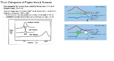

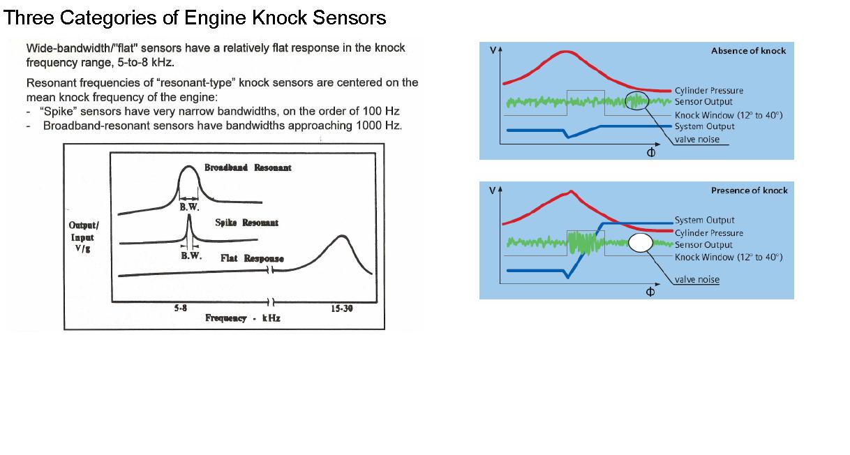

Haven't read through the entire thread. But here's some more useful data about knock sensors.
