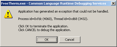

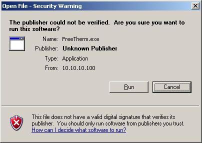

I got it working but I had some mild problems before I got it there. I orginally had it on a network drive, but got the attached crash messages. One happened in a recent MS update and is quite common, some kind of annoying security garbage. The other indicates freeTherm crashed hard. I then moved it to c: and it works just fine.
The network drive had name(s) longer than 8 char and no spaces. My guess it that something doesn't like the \\ip\ reference or perhaps it's a security thing with MS. Any how, thought I should note.
