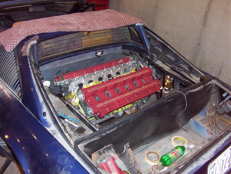

I’m a new member here and I figured this is as good a place to introduce myself as anywhere. My name is Mark and I’m a mechanical engineer. I’ve been playing at racing in various forms for almost 30 years now. I work in new product development and I have some decent experience in specifying system input/output requirements…so I know a lot more about what the engine needs and wants than most and probably a lot less about what the electronics are actually doing than most on this forum.
My current project is an 84 Ferrari 308. I’ve had the car 9 years now. The first thing I did when I got it was spend a year to rebuild the engine and design and install a supercharger system using a custom intake and an eaton MP90 blower. I installed a haltech E6k running multipoint injection with waste spark and it was good. It make 300 rwhp from the little 3.0 liter V8 and I drove it that way for a couple years.
After a couple years I decided if a small supercharger was good a bigger supercharger would be better so off with the MP90 and on with a whipple Ax2300 screw type blower with a new custom intake designed to hold a water/air intercooler. Off with the E6k and on with an E11V1. This setup made 420 rwhp at 22 psi on pump gas. The haltech just never quite delivered the control I was looking for so I upgraded to a motec M800 and things were good.
Fast forward a couple more years to the current project. I pulled the V8 out and bought myself a very tired 4.8L V12 from a Ferrari 400i. Then I got a set of 4 valve heads from a Testarossa saying “I’ll bet they fit” on the 400 block (which is a 2V engine). I’ve spent the past year and a half force fitting the 400 block onto the 308 transaxle and the TR heads onto the 400 block….it turned out this was a very bad idea and a just plain stupid amount of work but I’m getting there. If you are interesting in all the gory details I’ve got losts of pictures in a VERY long thread on the Ferrari forum, (they make you register to see the pics but its free and they don’t send spam). It should make about 750-800 crank hp at about 9000 rpm when complete
http://www.ferrarichat.com/forum/showth ... p?t=170171
I’m getting to the point where I need to be planning for how to control this thing. The engine will have 12 throttle bodies and 24 fuel injectors (12 show injectors, 12 port injectors). It will need to be sequential injection. I know, I know, many if not most of you probably believe that sequential injection is a only a nice to have and Hi/Low injectors are just plain silly but I that is an incorrect assertion that is not supported by any data I’ve ever seen.
The options at this point appear limited to a pair of Motec M800s linked over the canbus to share sensor info and tuning maps or wait (this will be about when the engine is done anyway)for the new Motec M190 that is due out in 6-12 months that will have 24 injector channels and 12 ignitions channels all in 1 ecu. Both of these options are really frikin expensive but I haven’t found any decent alternative….a pair of haltech plat 2000 maybe but then I’m locked into twin distributor ignition (which I may use anyway) and I’ll have to live without traction control or add a pair of firkin expensive stand alone TC units and won’t have saved any money. When I first stumbled on the DIYEFI project I was hoping there would be some way to make it work for me, but with only 6 fuel channels I would need 4 of them and that seems a bit silly and would be horrible to try and tune.
The frist engine test fit
The car
The car
