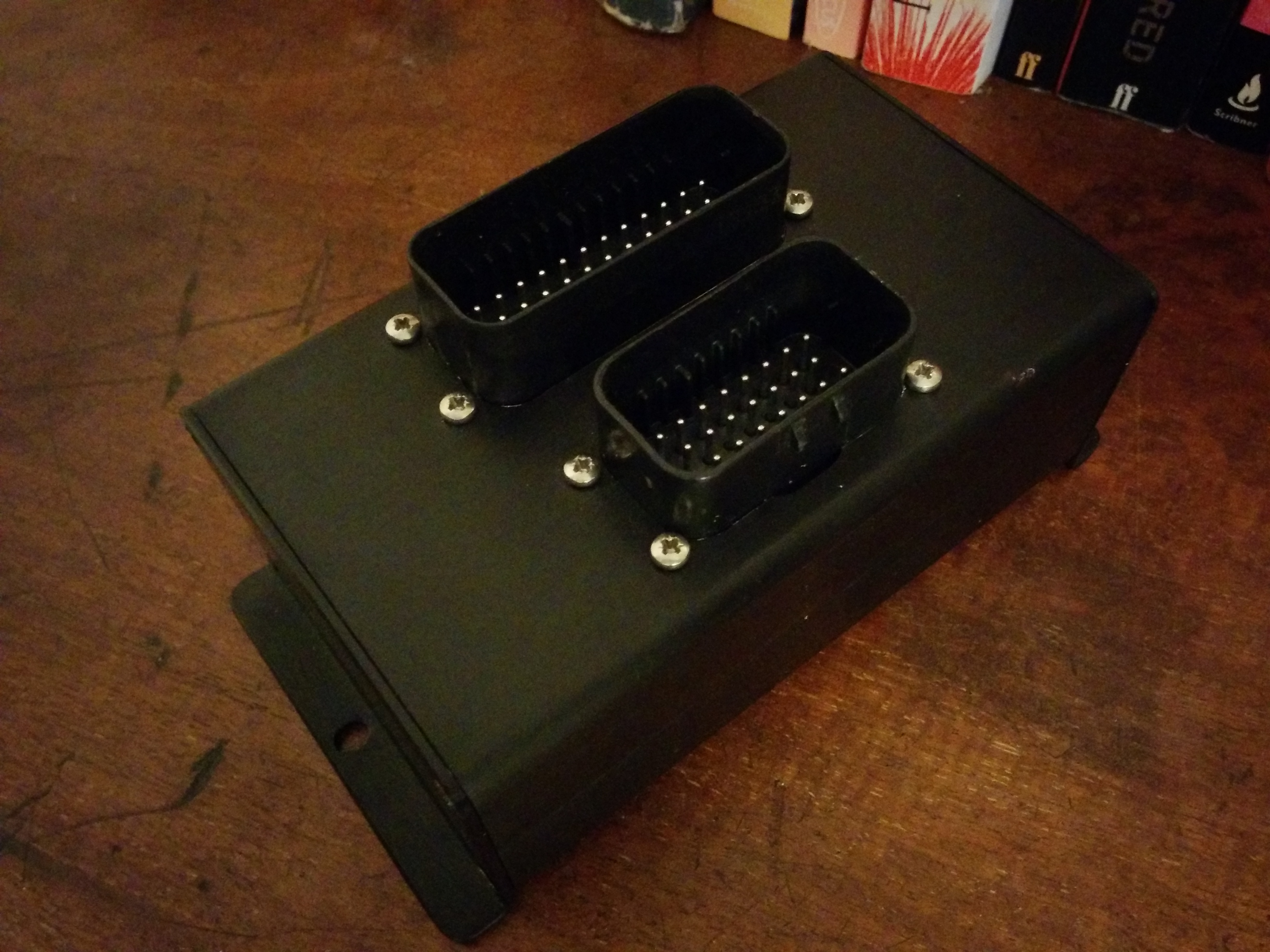

I did bring the Jaguar with me though, along with a bunch of sensors so I could carry on building it. I got to a point where I needed to ask a question about combining earths inside the enclosure and couldn't quite think how to pose the question, then I got a job and the excuses started piling up... With the holiday looming I should get it out of the drawer and see where I was up to. I think I realised that I didn't have enough pins in my connectors to run each earth separately and I wanted to know which could share pins.
Attached is a where-are-they-now pic.
Re: 1968 Volvo Amazon estate, 2.3ltr turbo.
What you can share depends on a lot of things. If I don't do a write up and link it here, nag me until I do.
Looking damn good, though! Haven't seen one with dual connectors like that, yet :-)
