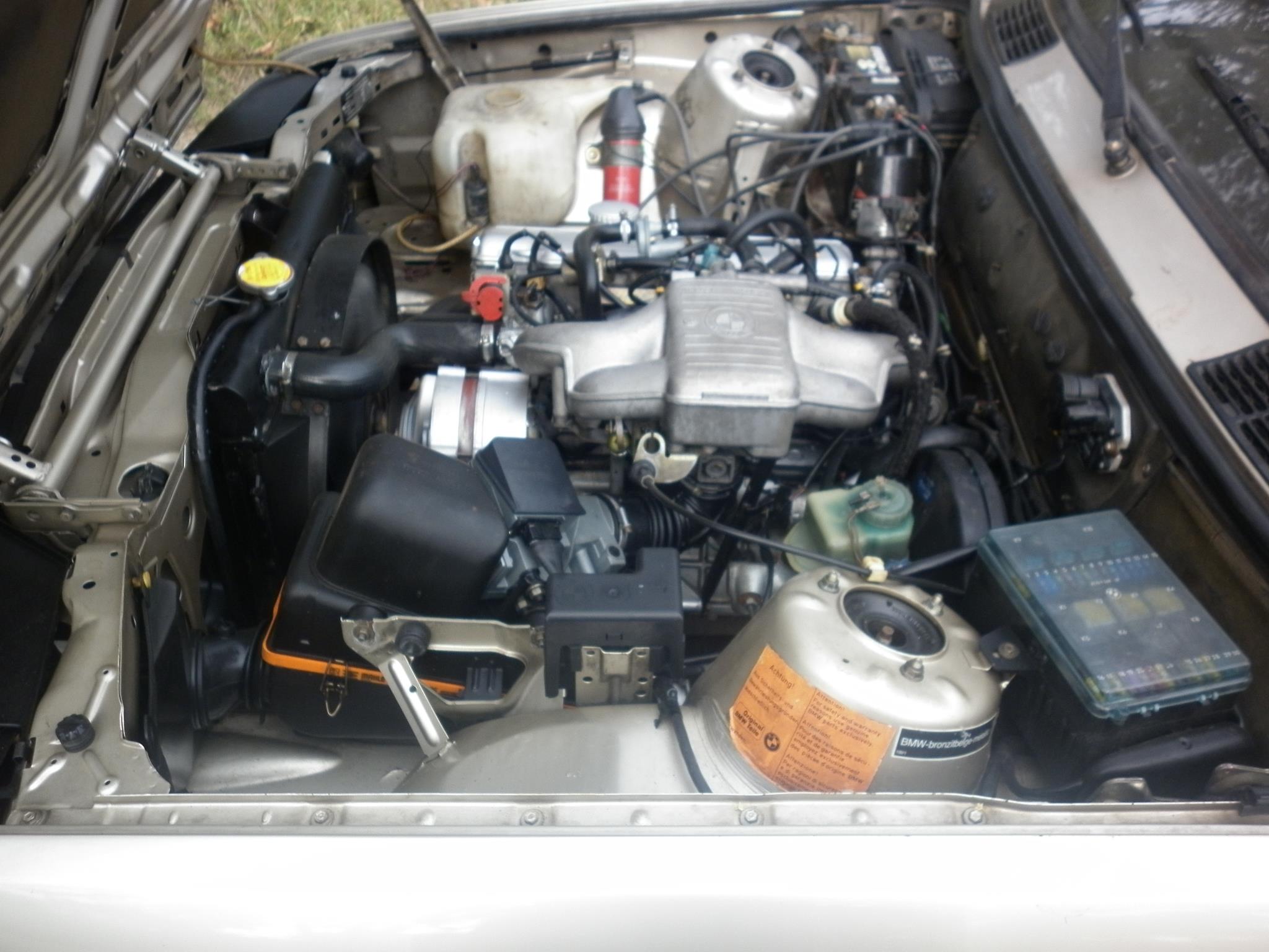

Here is some background information on Mr. Smith(yeah, it has a name) as it is currently. The car is running on its stock L-Jetronic EFI(Bosch):

I bought the car about 7 years ago and since then, I've been trying to get it back to its former glory as its condition(mechanically speaking) wasn't anywhere mint when I got it. Nevertheless the chassis is in good condition and with very little corrosion despite having spent its last 20+ years in Costa Rica(90% humidity and very rainy place). The list of parts that I've changed is long and most parts have been swapped for new ones(either Genuine or OEM). When it comes to the engine/EFI system I've changed:
Ignition Coil
Distributor Cap & Rotor
Distributor Cables(to spark plugs)
Distributor repair kit installed
Spark Plugs
Battery
Engine Wire Harness
Minimum Valve(ADDITIONAL AIR SLIDE VALVE)
Cold Start Injector(Starter Valve)
Throtle Position System
Fuel Rail Pressure Regulator
Grounding Cables
Temperature-time switch
Vacuum Hoses
Water Hoses
Gasoline Hoses
Timing chain, tensioner and sprockets
Cylinder Head was machined and left as new(valve seals changed etc, the whole shebang).
Cooling Fan
Cooling Water Pump
Thermostat
Filters(Gasoline, Air)
In tank Fuel Pump
External Fuel Pump
Radiator(Cleared up and fixed for leakages - not original but it works)

Here are some pictures:
