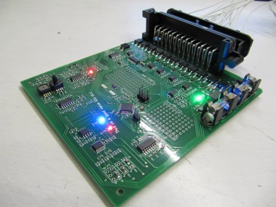

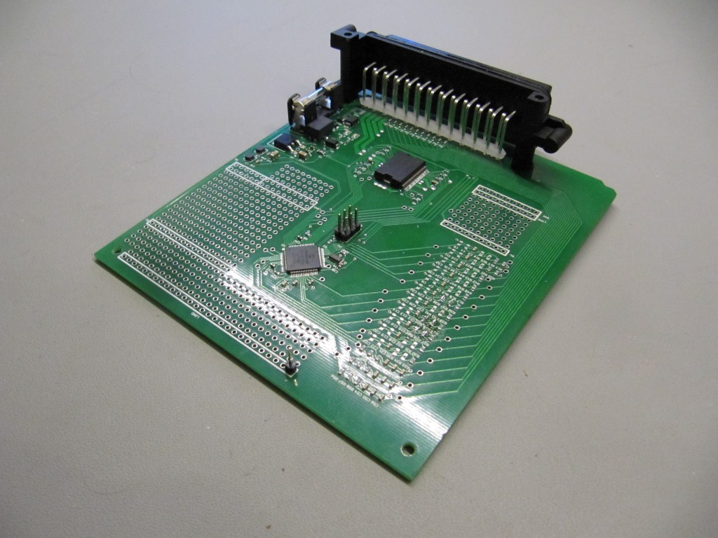

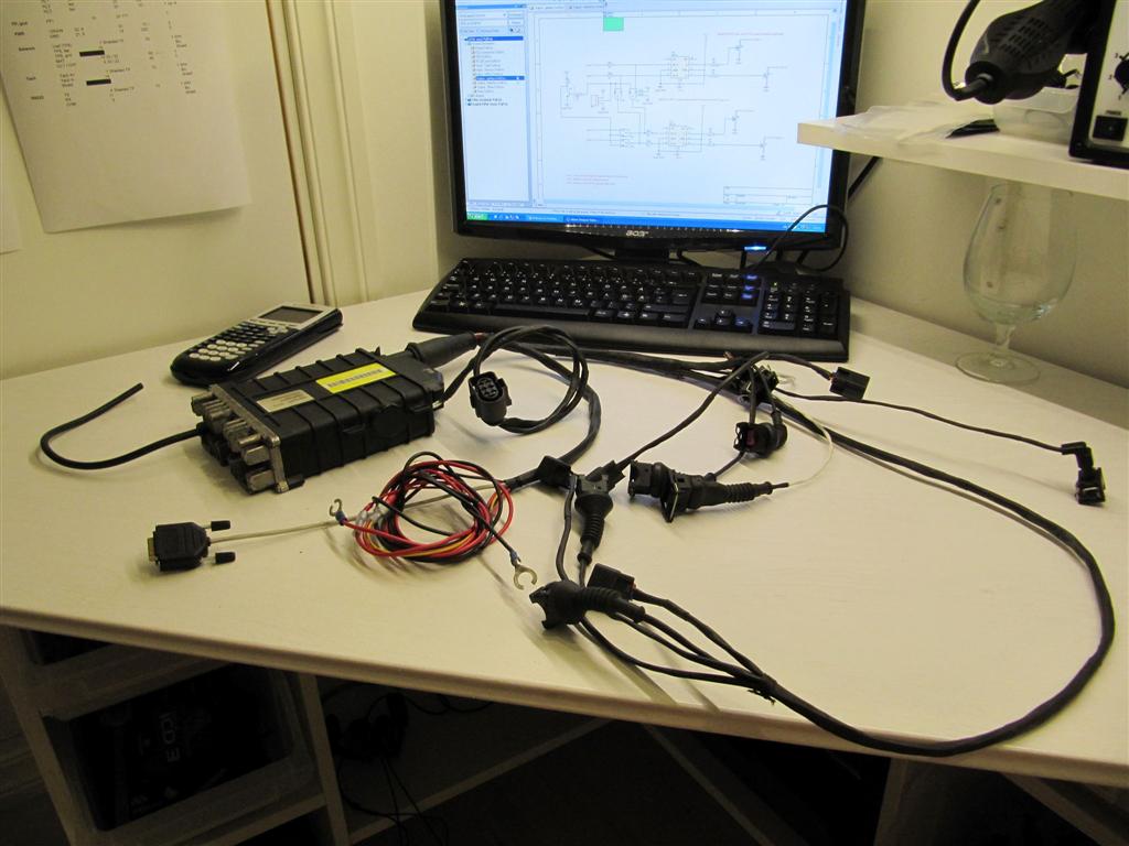

I decided that I wanted to make my own ECU that would suit my 4-cylinder needs.
The idea that kick started the process, was that I wanted to design a PCB that would fit inside an original Bosch ECU case, using the stock main connector that would be de-soldered from the stock Bosch PCB. That way I would end up with a design that was water/splash proof, more robust with better connections and at the same time letting me design a PCB with more on-board features than what the MS v3.0-board have out of the box.
The Bosch case i chose to go with initially sports a skinny 25-pin connector. Although, in the beginning that was adequate for my 4-cyl. aircooled boxer-needs, running full-sequential CoP and injection with two tach-inputs (36-1 crank + single pulse/ 720 crank deg. distributor module) and idle control.

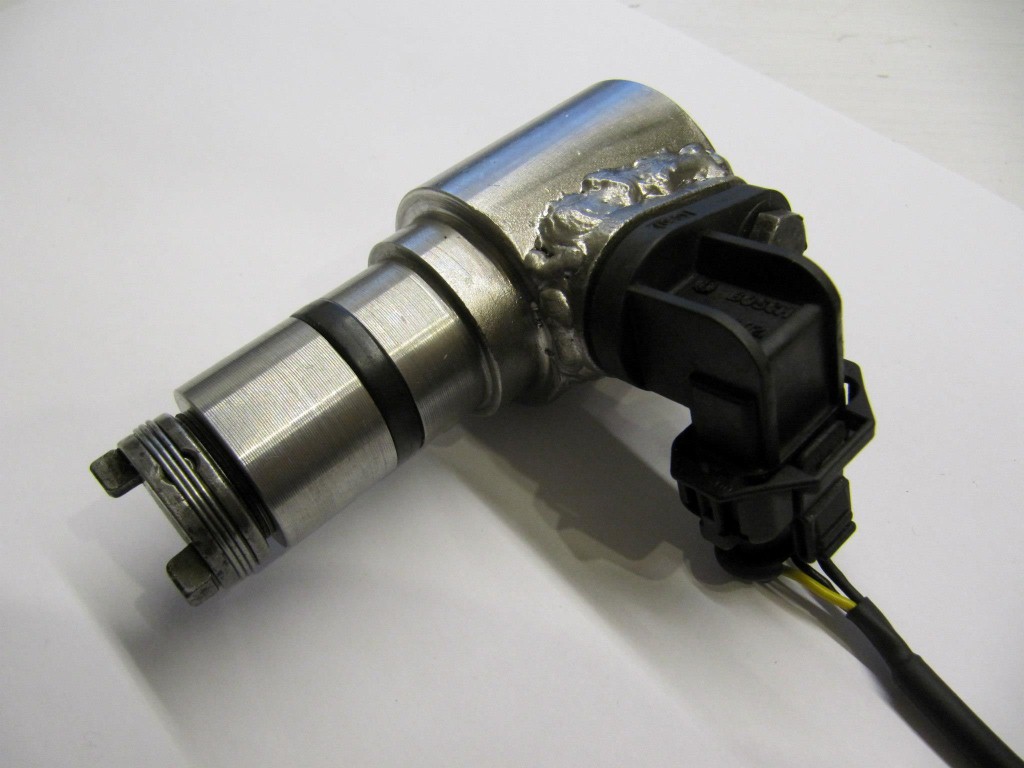

Preferring electronics and elimination of mechanical parts, I have also started developing a dual-DBW prototype that I would like to incorporate into the ECU.
