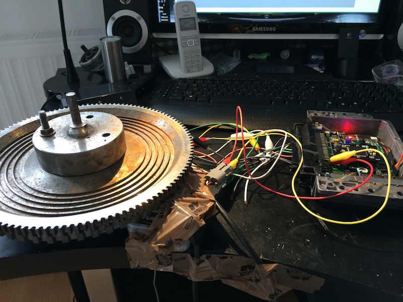

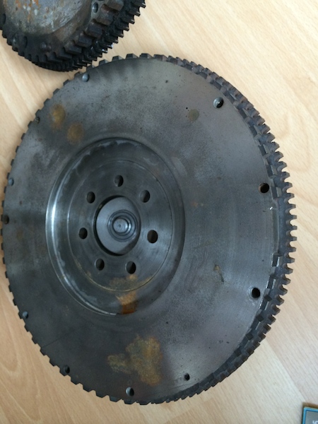

managed to get a "real" 60-2 trigger wheel.
i made a test bench for the trigger wheels so i can turn them with a drill or by hand.
I got perfect sync with the "real" 60-2 Trigger wheel .. it sync´s already at 40 rpm ... this is really good compared to the M$ wich sync´s at 120 rpm.
So now i´m 100% sure that hardware config and the values in "fixed config 2" are right !

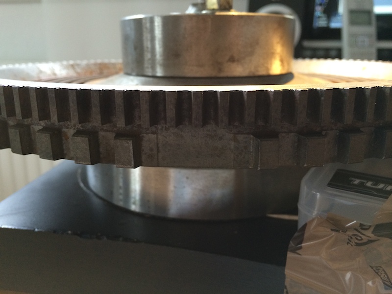

With the 60+1.5-1.5 wheel i have Sync Loss Reason 64 at event 57
As i think this has to be the tooth # 58 .. it is simply to long
Tried to figure out wich part of the code is responsible for this issue .. but for me the code is very hard to understand :?

Had an typo !
CAR is running now !!! :lol:
Fred get me on that List !! :D
Video will follow !!!

Apologies for difficult-to-understand missing tooth code! It's one of the more complicated pieces of code in the firmware. There is a full write up on it here, though, if it helps: viewtopic.php?f=56&t=1340
