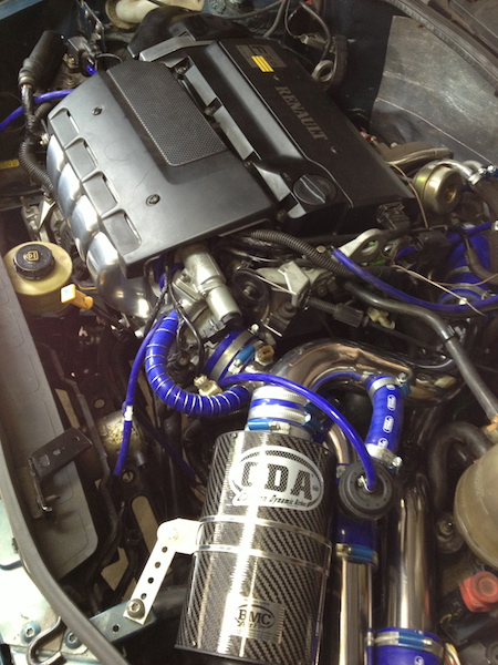

Also got the same car in green and with turbo conversion.
Owner: Me
Make: Renault
Model: Megane
Engine: turbo 16v 4cyl
Capacity: 1998cc
Power : 250hp+
Description: Garrett TB2804 Turbo, custom air to air intercooler, forged pistons and bad con rods from PPM that caused a engine failure ...
Regarding to the fact that green Megane has an engine failure the red is getting the FreeEms.
So plan for the future is to develop a bullet proof ECU and use it in the turbocharged Megane.

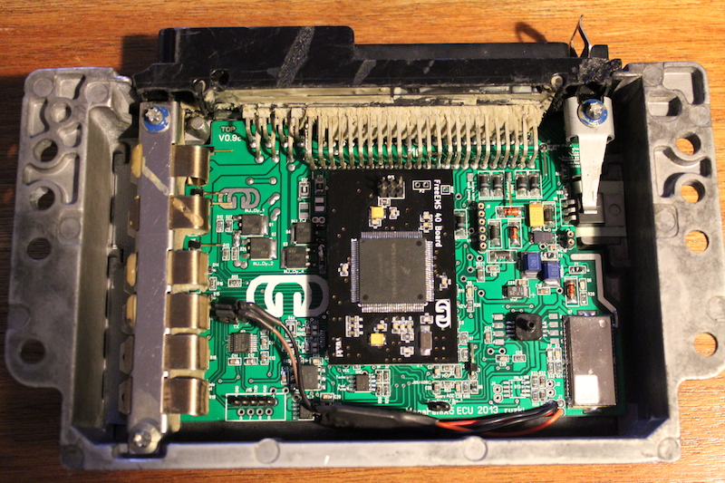

At the Moment im running as i said before a M$ derivate. It is running pretty well buuuut Mr. Robert Bosch says that my ECU is no t legal :lol2:
So i want to build a FreeEMS !

My next goal is to build a firmware wich can support the engine configuration.
People in Germany need to go stealth with their modifications so i will build the FreeEMS in the original ECU housing.

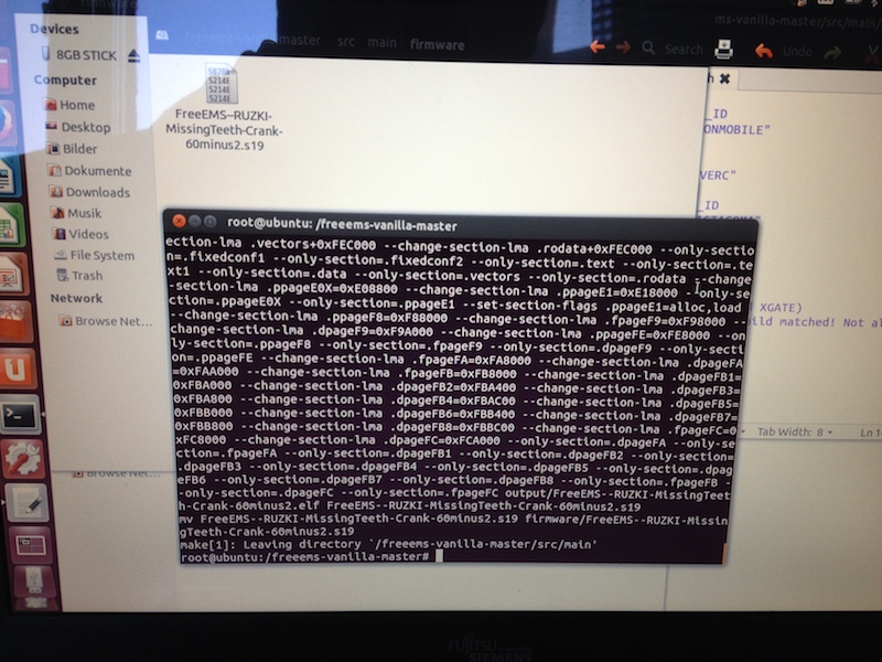

After trying to build the firmware on Windows Vista and MacOSX i finally had success with Ubuntu ..
First Firmware build :lol: .. created an ID for my build..
After i checked all the sensor readings i tried to crank the engine.
LOST SYNC Reason: 71 :? :?

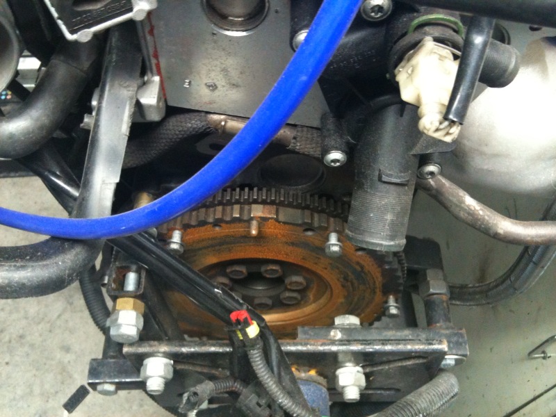

Switched the polarity of the VR sensor and made a second datalog.
Yes there are more than one Sync error reasons.
I think i know why it is not working ! (pictures below)..
Also attached the datalog and source code ..
It is a kinda 57 +1,5 tooth -1,5 gap .. something like this .. :lol:
It think it is that way to prevent the engine from turning in the wrong direction.
Datalogs.zip
(521.84 KiB) Downloaded 1428 times
