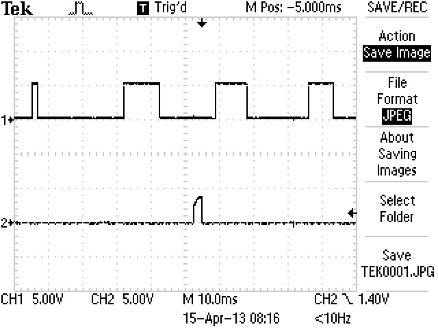

That is interesting re: the 12V to ignitors. I noticed the ramp off in the rising edge of the coil trigger signal too. So the "5V logic signal" could be just a Darlington VBE then?
Have attached a similar trace: R33 CYL1 Ignition vs CAS SYNC/POS.

Yes, exactly, and I've been saying this for years (3 of them) and knew the MS2 ignition on my truck sucked badly, but didn't know why until I got my hands dirty and "proved" it. This is nice confirmation from an OEM box.

Yeah, I saw the scope trace and thought that it was 5v out, until I was poking around inside the stock ECU and noticed there wasn't any regulated voltage going to the driver chip for the ignition, just 12v. So all you're seeing is what isn't dropped over the BE junction.
