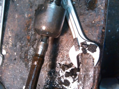

Wynne's stop-leak is holding so tried to get it through roadworthy/mot/whatever its called in your country. Failed on steering, surprisingly.
Removed steering box, found a bush was .. um .. just look at the picture
- This is the remains of a bush
Incredibly, found a replacement from the local Lancia man. Came with a delightful story about how this bush had been imported 10 years ago for the president of the Lancia club's son who never paid for it and and how they have been enemies ever since. So they were happy to get rid of it for a bargain.

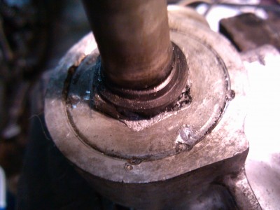

However this was just Murphy setting me up for a fall as the flanged nut on the pinion shattered during disassembly. Strangely happened after it had already loosened. Not sure what to do now so I've turned to booze.
- damn! damn! damn!!!

by Fred
Maybe drill two (or more) ~6mm holes into the face of it and make a special tool to turn it with X dowels that hang down into the holes, kinda like circlip pliers but stronger. If you don't need the nut part, this could be OK for the long haul? If you do need the nut part, use it to get it out and have an engineer make you a new one on a lathe. Or import/find one. It's cast! :-o wtf. Good luck! :-)
