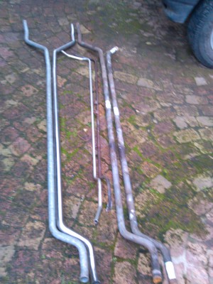

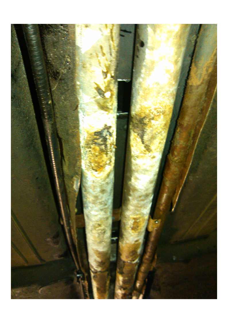

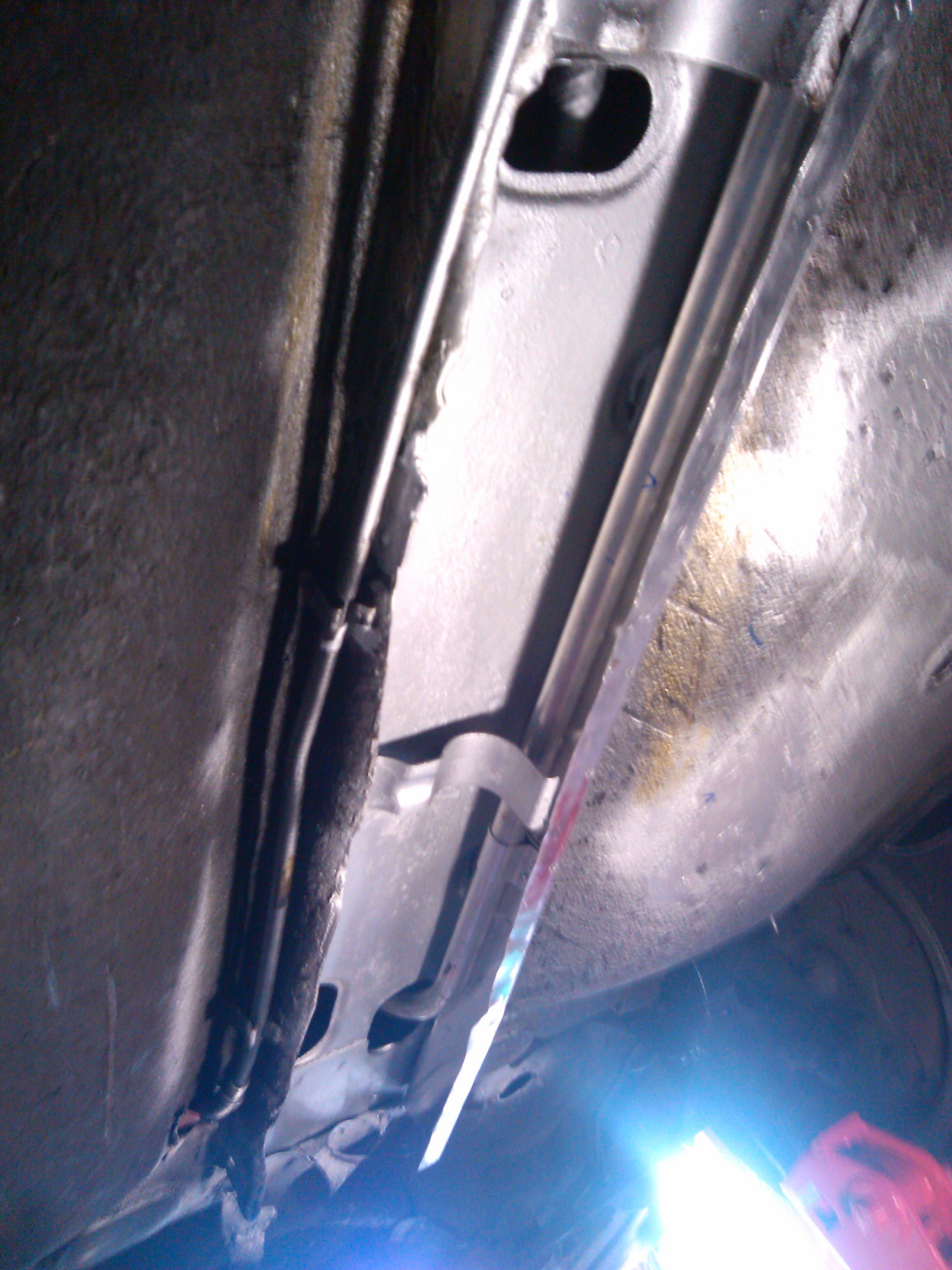

I finally got into the old girl's pants. Not a pretty sight!

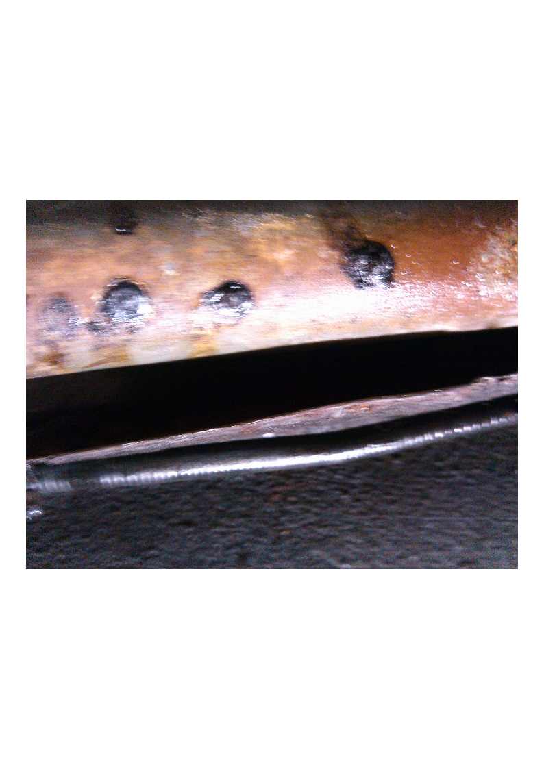

I started off trying to drill out the spot welds but soon said "golly this is not worth it" or words to that effect, and just cut the damn thing open. It was not worth saving anyway, I will make a replacement out of galvanized sheet metal.
I don't have access to any lift or pit, so all this was done with ramps and jack stands and working inches from my nose.
These spots are radiator stop-leak. Lots of muckies in the pipes, the rad will also have to come out and be professionally cleaned.

I managed to find a genuine original unused pipe from a local guy, the other one I will have to get made up. It has a series of complicated bends at both ends.

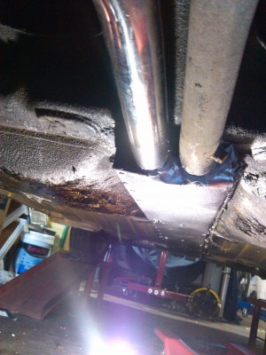

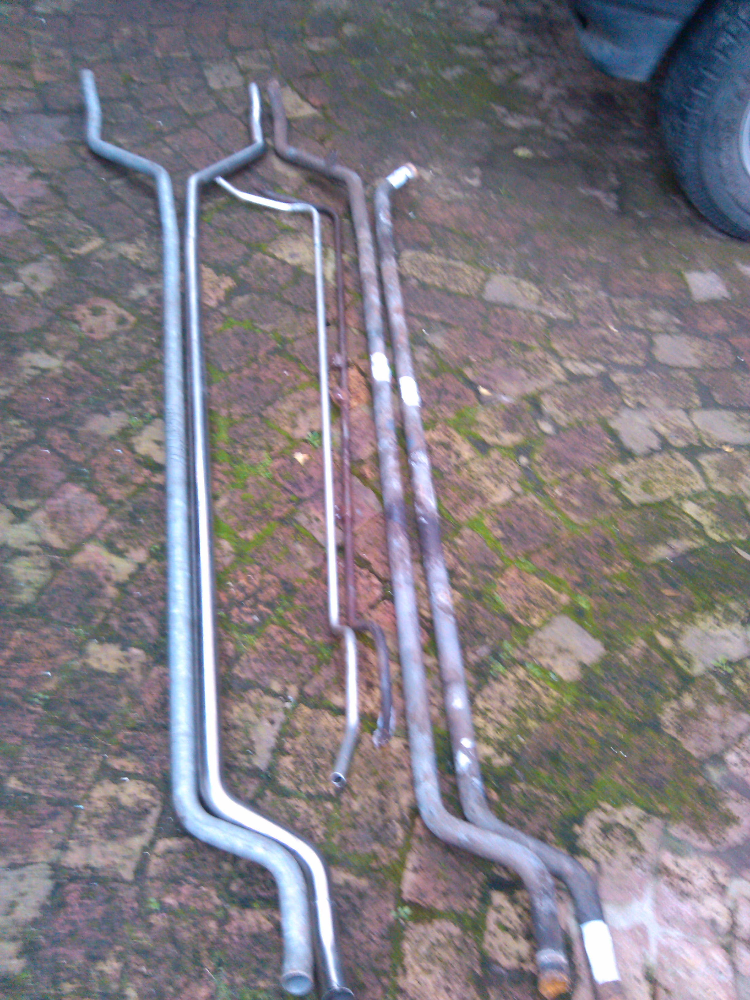

I drilled out most of the spot welds in the end, but left one side of the original belly pan.
I had a second pipe made up from stainless as nobody would make one in aluminium for me. the small heater pipe was made in alu.
File comment: The old and new pipes. the small one is the heater pipe.
The inside of the belly pan was cleaned up and sprayed with rust converter and hammerite. The right hand side you see here I made in alu and riveted on to the body. I attached the small heater pipe first.

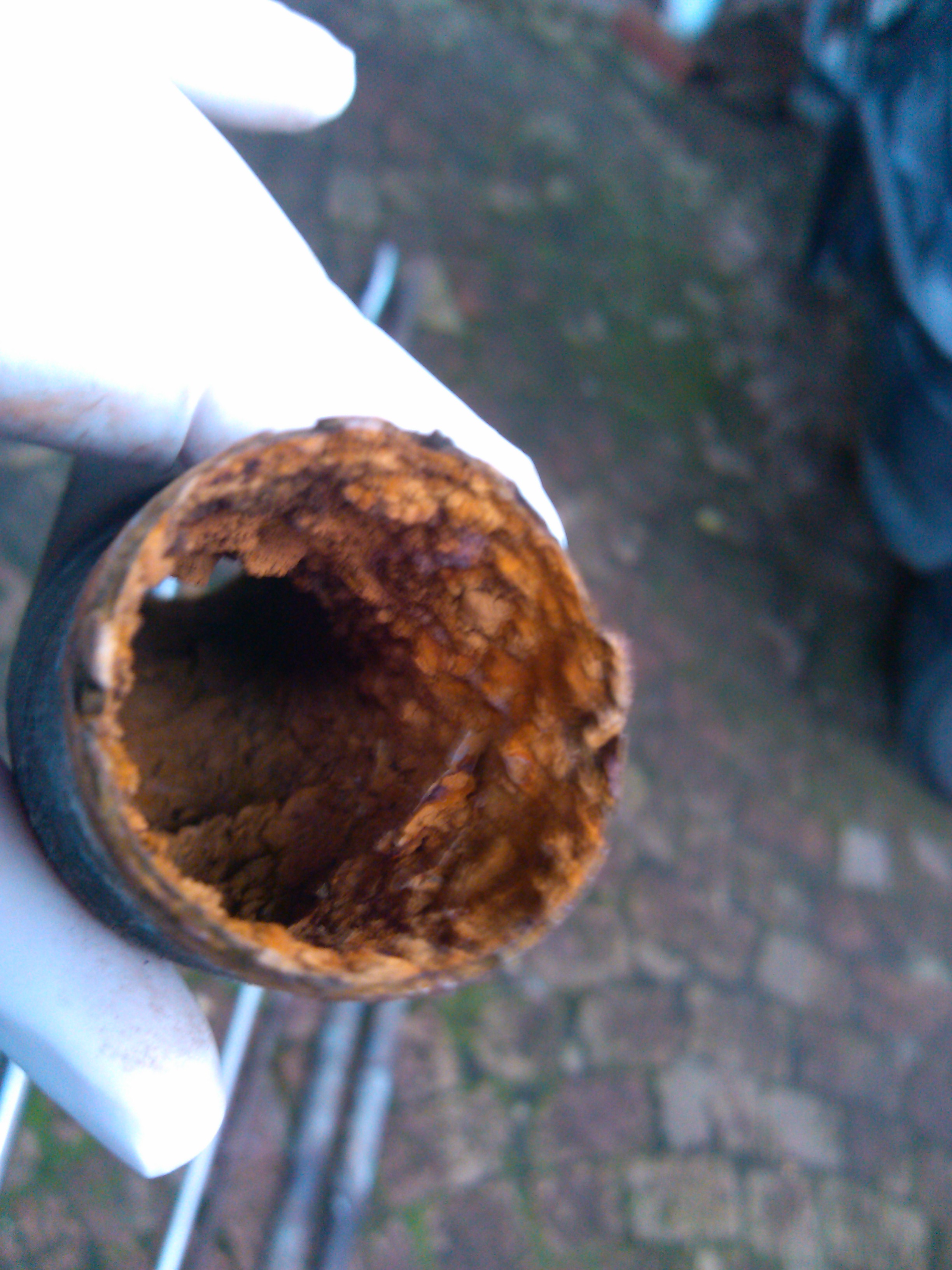

File comment: This is the inside of the old pipe. Mind boggling. I fear for the block.

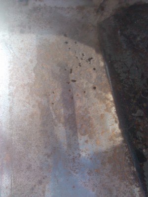

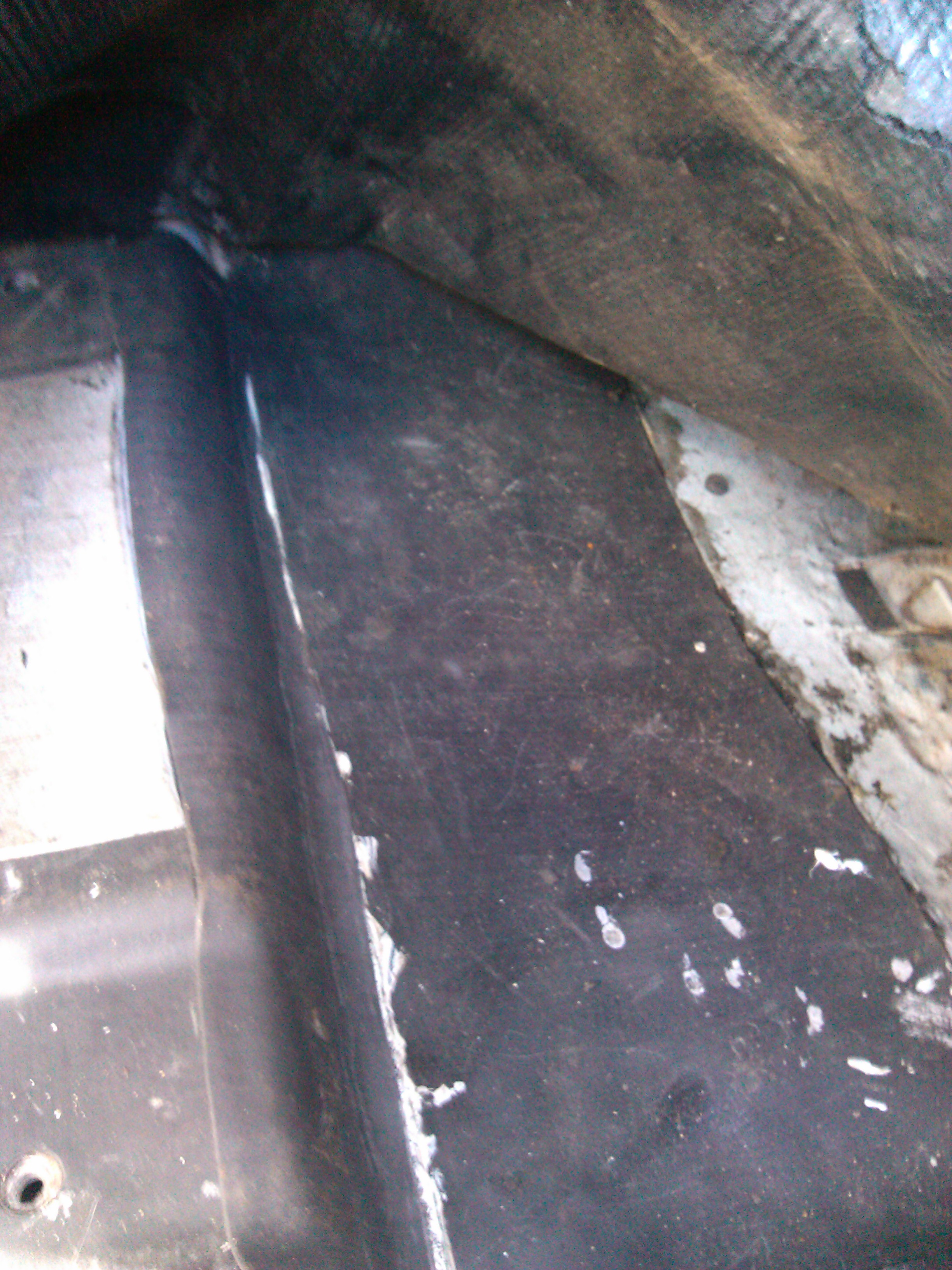

Interlude: the driver's floor was rusted right through. Thoroughly cleaned with wire wheel and rust remover, coated with rust converter, sanded, etched primed and painted with anti-rust paint before being glass fibred and covered with sound block.

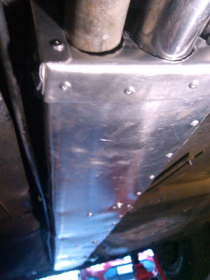

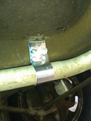

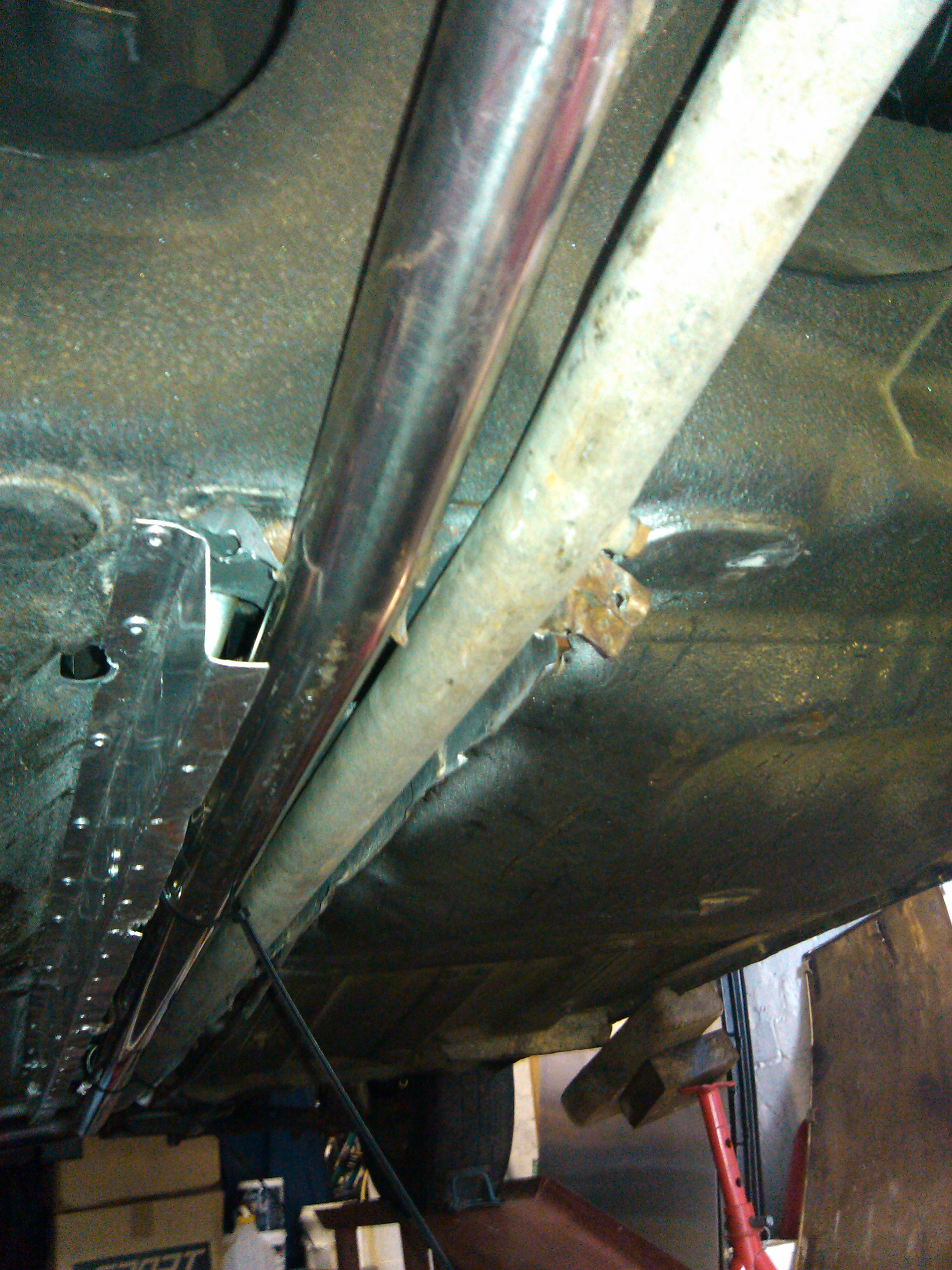

The pipes were then fitted and held in place temporarily with cable ties. I put some rivnuts on the inner pipe supports so when the bottom cover was riveted on I could bolt them tight to stop any rattles. I also glued some rubber to the inside of the bottom cover.
File comment: Pipes fitted
File comment: A view from the front with the cover riveted on

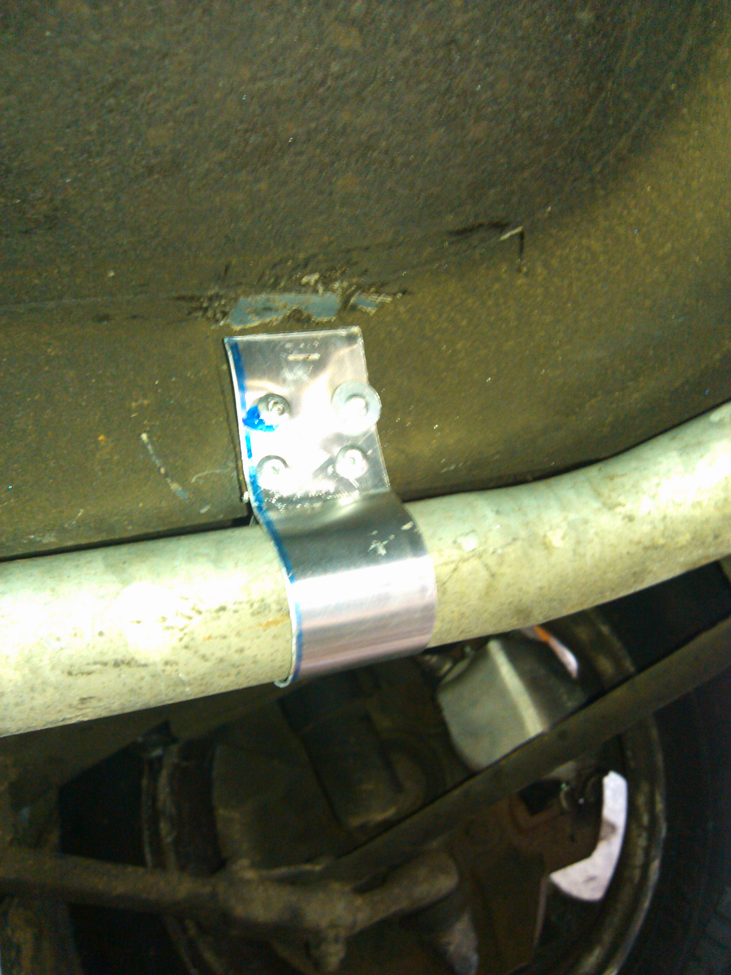

I then made supports for the front of the pipe near the radiator.
File comment: Home made front pipe support

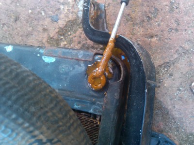

Interlude: cleaning the radiator.

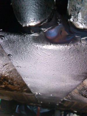

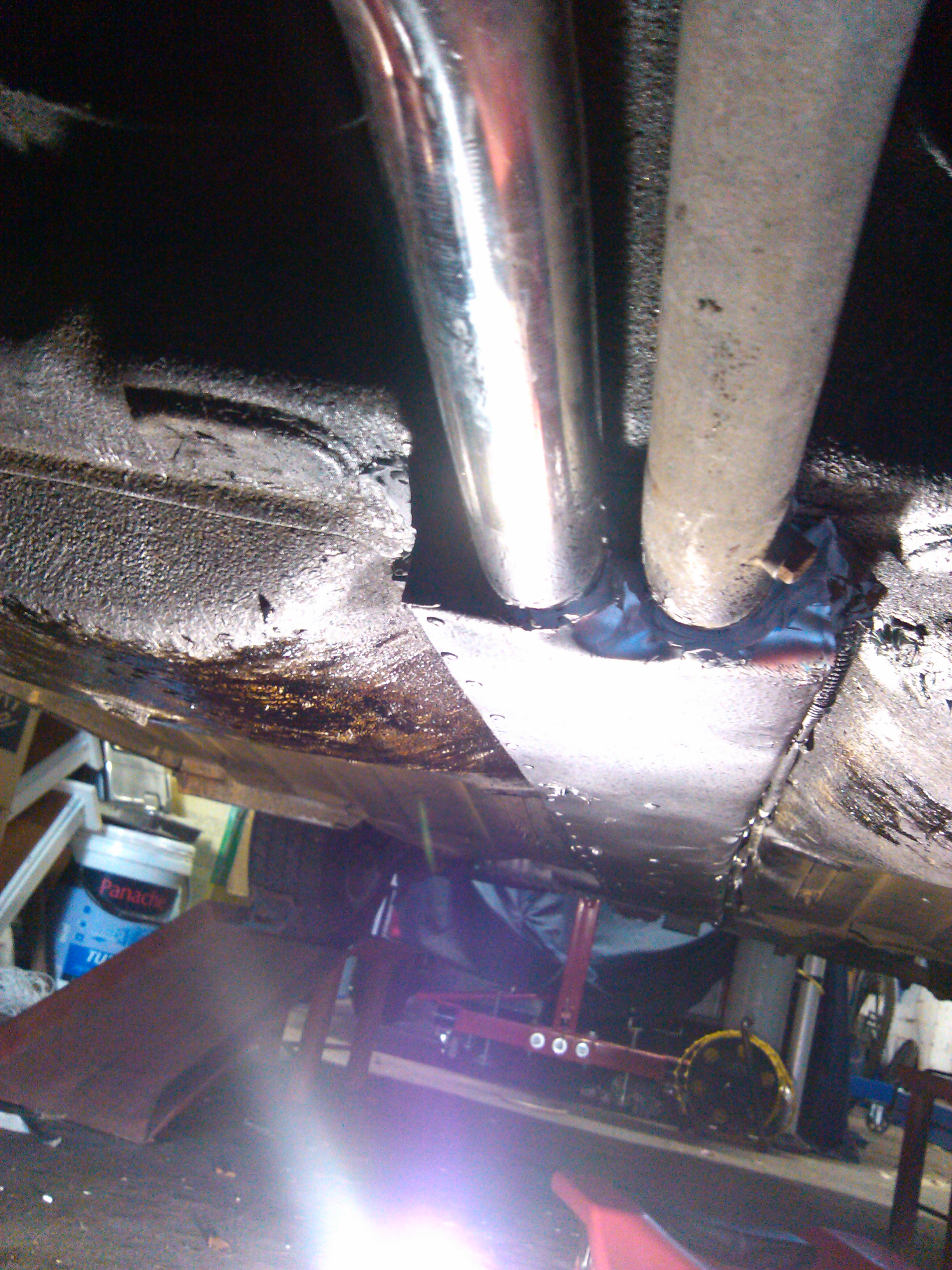

The finished product, car is back on the road although it will soon be taken off again to do a engine out serpentine belt conversion with a triggerwheel. And to to check the block of course. Plenty of work to do. I've also acquired a hotter cam.
File comment: A view from rear prior to sealing and painting. The cable on the left is the speedo cable (which Haynes claims is an accelerator cable)
File comment: The final product spayed with stone-chip. The gooey looking black stuff on the left is Devil's Diarrhea (bitumen based chassis black) to seal under the driver's floor.
