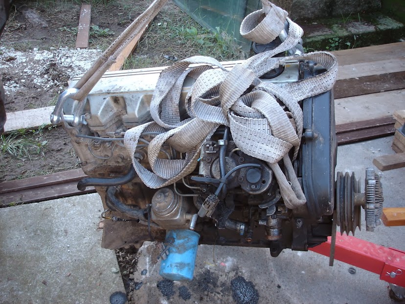

The RD28 stripped out of what I need, you can see here how corroded the block was, and there was some shears of metal on the oil pickup.

Weirdest oil sump. Note: you need to take the flywheel and the bellhousing plate off to remove the last 4 10mm bolts.
Removed those plates and the stock oil pickup, then I used the r28 oil pickup modified, I streched it exactly 10 centimeters horizontaly.
This is the driver's side engine mount (Left hand drive), there is a an oil line, and sadly the AC compressor gets in the way of the mount (the rubber pice) just by like a 1mm, that sucks, I ordered an AC equiped one just to get onboard air working as easyly as possible, i might have to hack the mount of my old compressor on this mounting, as its much smaller than this one. With the AC compressor off you can just bend the oil line by hand and refit
The RD28 clucth and flywheel, yes that is big and heavy, i will look onto a machined one in the future.
