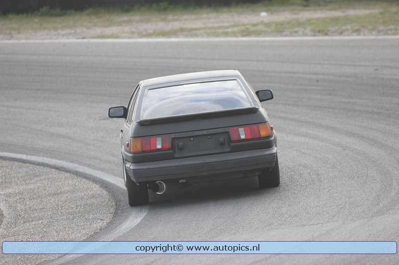

My nr1 project is a 1984 Toyota Corolla GT Coupe, known to most as an ae86 levin coupe.
This was my first car, and it has a special place in my heart. Good thing, because it would
otherwise surely have gone to the scrapheap (20/20 hindsight on the rusty state of the car).
Here it was in the early days (2003):
Pulled her apart around 2007 for obvious reasons:
Got delayed, nothing much happening up till last year when I moved into a large garage unit with a bunch of
my old car nutter friend from the south of the Netherlands (Brabant).
Since then I have been welding 2 to 3 weekends each month (yikes!).
roofswap:
Rear suspension redesign (needed too because it was sooo rusted:
Escort Mk3 arches:
It is now in the finishing stages of welding.
