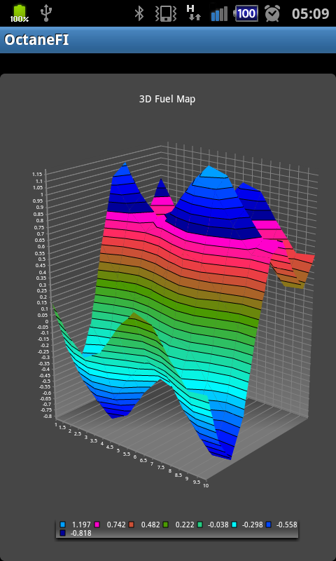

Really cool, dude. I used to love PICs, but never made anything this intense.
The Android app via bluetooth really takes the project to another level. Is it mostly a visualization tool or can you make on-the-fly adjustments as well?
Love the mellow exhaust note. Those throttle chugs sound like a stoned elephant.

ToxicGumbo, I really love PIC32, things imported are complicated to buy, also very expensive. Microchip it is easy, have on the domestic market. The Android Software does everything, I'm still developing functions.

I'm interested in the android app, mostly.
That is the most wild fuel map I've ever seen :-)
