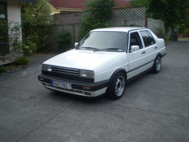

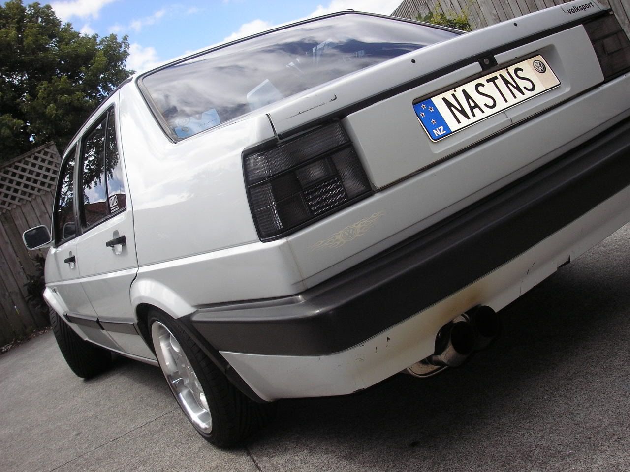

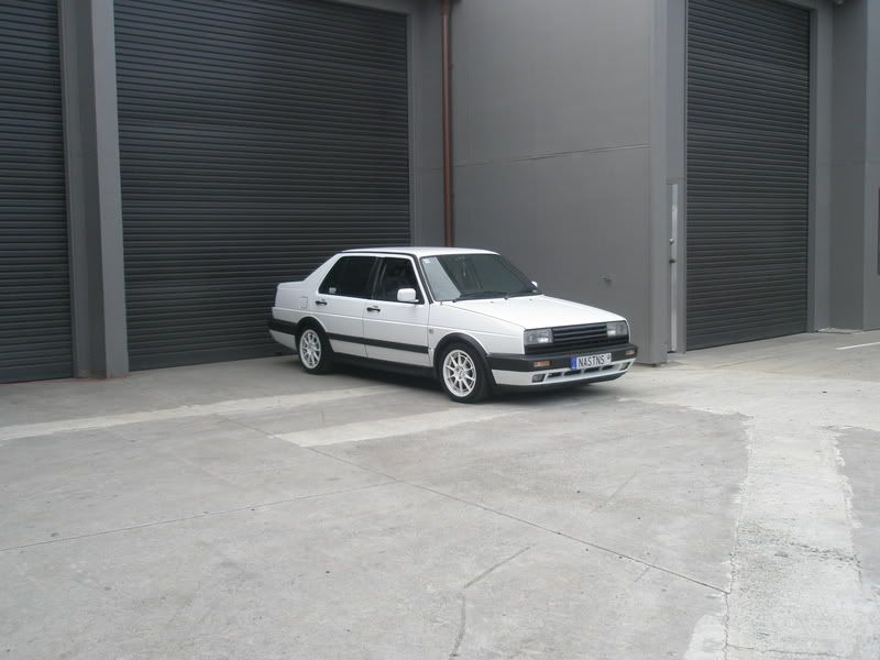

here are some pics of the beast!
and yes, i am a wheel whore, and the wheels are now changed!
