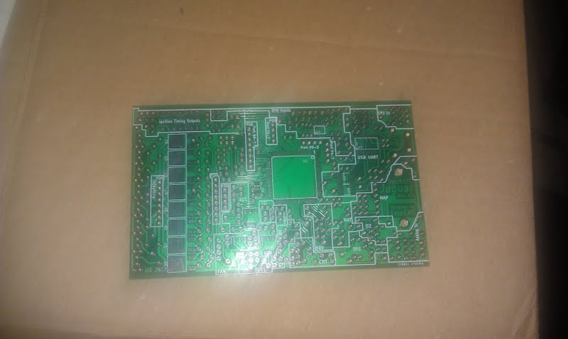

I opened my mail today and this showed up
Thanks Kenny!!!
It may actually be cheaper to turn this into a dev board as opposed to purchasing a TA card... we will see.
