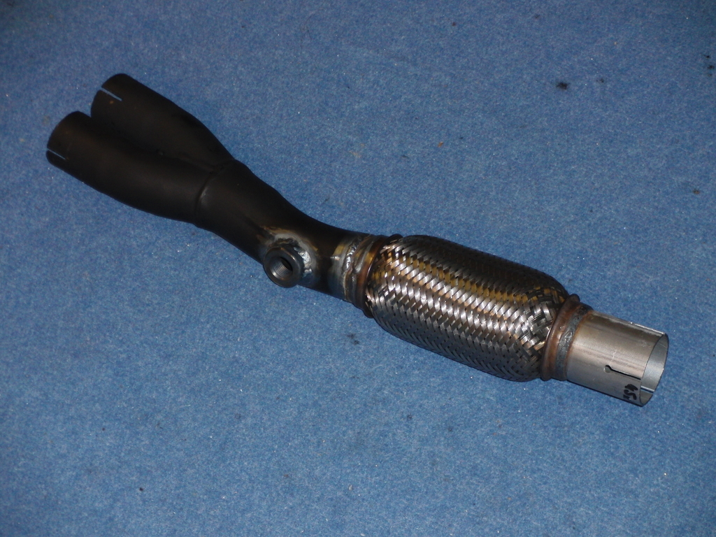

Couldn't do much these past days, except for cutting up the Y- and flex-piece and welding them together:
Seems to fit, albeit close to the gear lever mechanics.

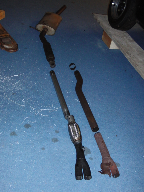

I've finished the exhaust, replacing the larger pipe with a 45 mm one. The old pipe had been rotated lengthwise to somehow fit, but hung much lower (3 cm or so) than the new system. Now the entire system sits much more snugly in the tunnel.
The new pipe was very precisely round, however just didn't fit with its 45.4 mm actual diameter. :?
Turned it down to 44.9something mm and reused the formerly cut-off collar from the flex piece at the existing first muffler.

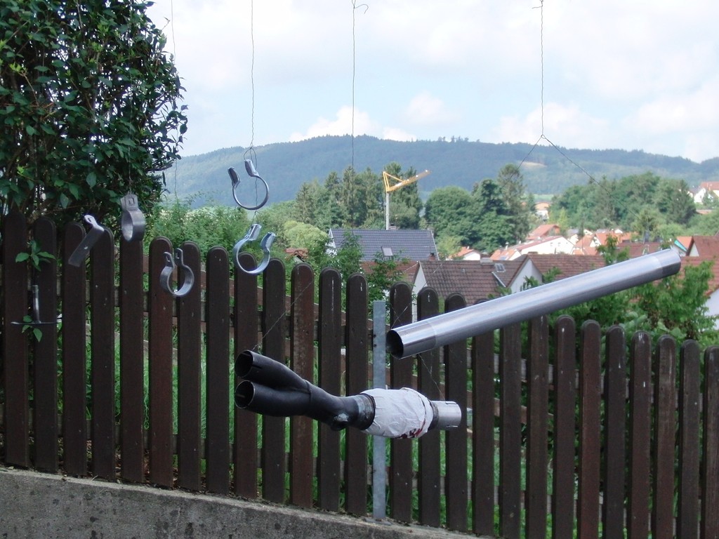

My beautiful wind chimes, ready to be painted.
